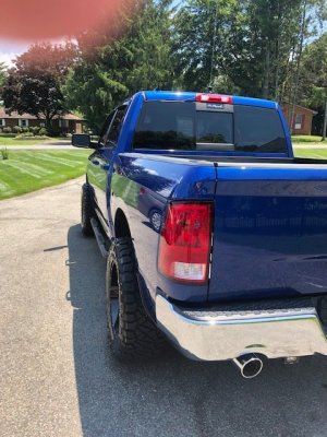

So im rocking 20x9 Ram sport wheels with 35x12.5 tires on a leveled Ram and I THINK the offset on these are 19.5mm.
In addition I have 10mm hubcentric spacers and I love how they look push the tire out.. Does the 10mm spacer change my offset to 9.5m which is what I'm currently running?
The reason I'm asking is I'm looking at getting new wheels either 20x9 or 20x10 but I want my tires to stand out just like they are now but no further.... I needed the spacer because the stock tires rubbed my control arm. 669ca5187731a0b2023537739aa1b5bb.jpg
