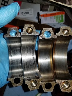

If the shop says that my crank is bad, I'm going to try and find a used 6.1 crank, the 6.1 rods and the forged 5.7 pistons like you (I think it was you anyways lol) mentioned on the previous page. I'm not sure how good of condition the rods have to be in to be reused but this is the one the spun the bearing. Second pic the one on left is the "bad" one and one on right is a normal one

I’m no expert on cranks, but you probably are looking at replacing the crank if it spun a bearing. I don’t know how much can be machined to fix it. A 6.1 crank and forged rods are a great way to go, but figure $250 or more for a used crank, and another $600-$900 for forged rods and pistons. Those are probably not really necessary unless you plan on running big power down the road. It’s best to do it now rather then later if you can afford it rather then rebuilding the engine later.
