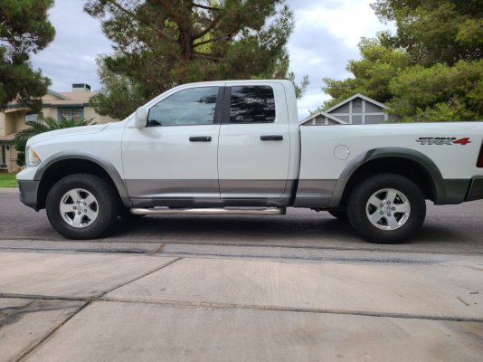

Here is my 2010, bilstein 5100s front and back.. set at 2.8 (2.1 higher than stock. UCAs changed out. 285-70 17s
Airlift 1000 bags set at 4lbs on back for those loads that might make it sag a bit can pump it up.
