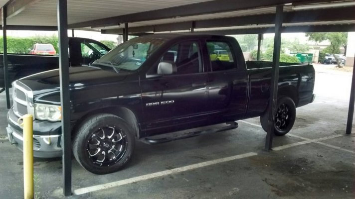

Hey guys I have a stock dodge ram 1500 with the 5.9 magnum. I wanted to know if it's possible to upgrade my brakes to ram 2500 brakes? If so not what should I do for you increased stopping power? 027bc862447c003607c734ce307f18fa.jpg
