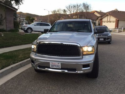

Hey gang,
I searched this and other forums. I am second owner of a 2010 1500 SLT with a 2 piece chrome bumper with fog light holes. It is not prewired for the fogs. I found part numbers for the fog lights, the brackets, the harness and the switch w/fog for the cab. What I need to know is how to hook the harness up to the TIPM. After that, I will get the dealer to flash the computer. Anyone have a couple pics or a schematic?
Thanks!

How much was the projector conversion? I want to do the same to my 2010
