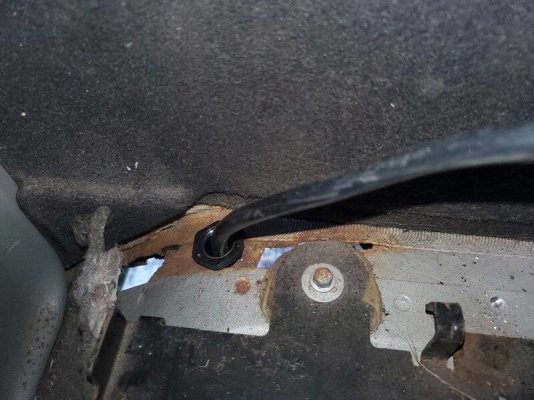

If your dodge is anything like my old superdookie...just lift the carpet
