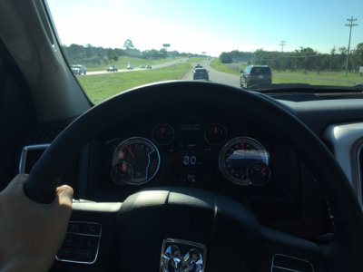

Having a similar issue but I have leveled my truck. So I leveled my truck and took it n for an alignment, the steering wheel was off just a little to the left afterwards but I had to get to work so I figured I would take it back and have it checked again when I had the time. Just over 2 weeks later my steering wheel looked like this. I need to rent a tourque wrench and tourque down my track bar as the one I have only goes to 150. I just had it realigned I'm going to tighten up the trac bar today and see how it holds up.

HD trucks are not glorified cars like 1500s are. They're trucks with a solid front axle.
They tend to drift slightly with the crown of the road. You'll notice on a 4 lane roadway that it will drift slightly right and steering wheel left in the slow lane, and drift left with steering wheel right in the passing lane.
Your second photo illustrates that. It's normal, and requires every 5k to 6k miles tire rotation to make tires wear smoothly. It's part of owning a solid axle front end heavy duty truck. The modern ones are Sooooo much better than the 3rd gen
