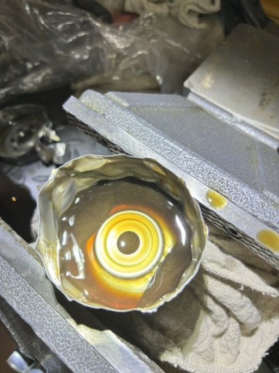

Hey Guys,
New 23 Classic 5.7 owner. I’ve noticed the truck has a tick while at hot idle. Mainly on the drivers side wheel well and underneath the truck. Can’t really hear it in engine bay. Can hear it when just standing near the truck or when window is down. It also seems to get louder at around 1500rpm as well then clears up after that.
Truck has 3500km on it. Mainly just wanting information of whether it is a normal hemi noise or if it’s the beginning of possible engine problems. I changed the factory fill at 2500km with Valvoline advanced 0w20 which didn’t help then tried Valvoline synthetic 5w30 at 3000km which also didn’t make a difference. Oil pressure cruising 49-52psi and hot idle 35psi in park. Truck seems to run great with lots of power just seems noisier than other Hemi engines. (I see quite a few at work).
On a side note I also cut open the factory oil filter after the service and found quite a bit of metal in the oil. I know new engines will shed metal but not sure if this is too much?

after the next oil change, would you consider sending a sample in for testing?

Have you had yours looked at? Did the dealer say anything? I showed mine the picture of the oil and mentioned noise but they didn’t seem concerned. Either way it has warranty for a reason. It’s just annoying when you show someone your new truck and it’s just ticking away lol.
I will most likely send a sample into blackstone when I change this oil at around 10000km. Which would be roughly 7000km on the oil. That should tell me if there is any unusual wear happening.

I would say I have listened to most of the hemi tick vids on this board, and with your vids I dont hear hemi tick. You may be looking at two different things, and the good news is the metal is nearly powdered and no chucks or slivers, which is good news. The other good news is you take the time to cut open your filter, keep doing that and taking pics, my guess is this is normal and will stop soon. In the future, take vids from under engine and leave the recording on for 3 minutes under running engine, this takes out any white noise. I wouldn't go messing around if you are worried, stay the course with OEM oil. At some point try the redline 5w30, it makes most engine butter smooth.

The good news is I actually start at a Ram/FCA/Stellantis dealership on Tuesday as the service manager. As I get to know the techs I’ll be able to pick their brains on the sounds I’m hearing. I do have a decent mechanical knowledge as I’ve managed a different service center for a few years now. I have however started to listen to most hemi’s as they come in and some make the identical sound mine makes, some are quieter and some louder it just seems like luck of the draw.
