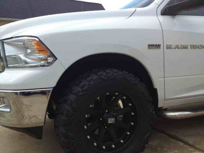

Just found this sight trying to figure out if I can run 35x12.50x20's on a 2012 1500 big horn with a leveling kit on it ImageUploadedByTapatalk1372807736.062731.jpg

I think you need a leveling kit and a 1.25"

Leveling kit with some negative offset rims should do the trick. Probably -12 or -24 I think.

I'm @ -12 with the Addicts

U have 20x9 -12 offset? U can run 35s with that . Plenty of ppl do but it will rub the valence some and maybe fender lil on hard turns. But it'll work . Just trim a bit if so

Id also do 2.5 level or 2.8 bilsteins adjustables to get as much lift for 35s

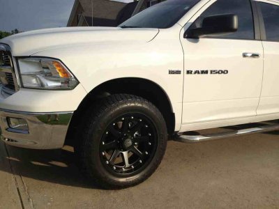

Here's my 2012 Big Horn before my lift with just a leveling kit. +0 offset on 20x9 wheels with 35x1250.

Just found this sight trying to figure out if I can run 35x12.50x20's on a 2012 1500 big horn with a leveling kit on it View attachment 14260
Yes you certainly can.
20x9, 0 offset, 35's and 2.5" level = winning
zero rub I may add too ;)
I know of a member who did max bilsteins (2.5-2.6" once settled) and fit 20x10 -24 on 35" Toyo Mt and it fit with bending of the pinch weld and some trimming on the lower front valence (this applies if you have the sport bumper, which you do)
Dremel will be your friend at this point ;)

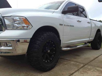

I'm wanting to add one of these soon ImageUploadedByTapatalk1373112305.746943.jpg

Mud grapplers. A little noisey but I like it
