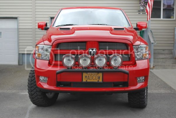

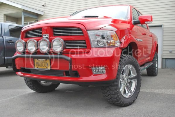

I just had my westin light bar installed with 4 7" 6000K HID's. I had the Light bar rhinoed lined and two switches one for each set installed. They are also hard wired to my high beams so look out moose I can see you now. Oh you will notice a large hole cut out of each side where the light bar mounts to the truck. That is on purpose I will be installing some tow hooks here once I can find a cheap set. Well enough talk Pictures.
I will take some better pictures of the truck tomorrow.

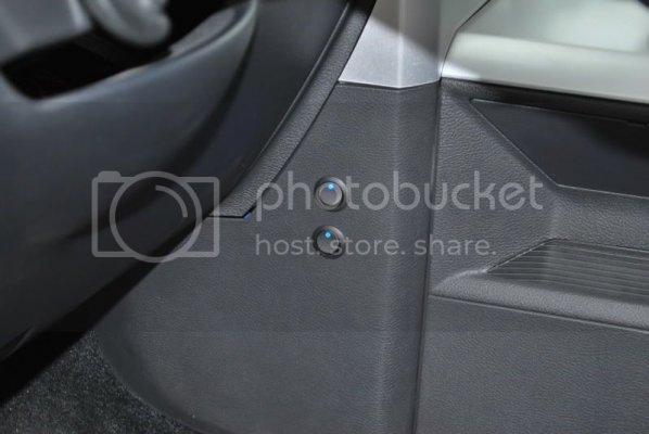

nice! how hard was the install to the switches on the inside.

I did not do the install but it did take 2 guys 4 hours for the entire install and that counts the time for the Rhino liner to dry.

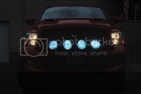

thats hot man. we need some night shots of the lights

Lights look awesome man! I like where they put those switches too.

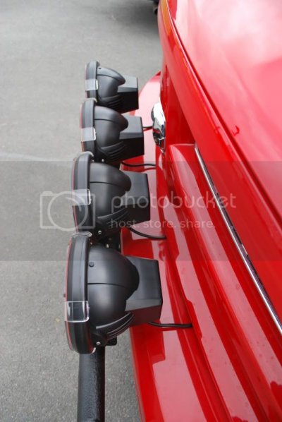

Just curious, why didn't they run the wiring for each light through the bar? It would have required a little drilling, but can be done. I would be concerned over time that that those wires running across there might start to rub/blemish the paint. I think I have a picture of mine in photobucket if you want to see what I'm talking about. Wouldn't be too hard to do yourself from this point really. Assuming they left you some slack it would just require a little patience to fish the wire through.

Looks really good, but I agree on trying to get the wires through the bar itself.

Dont know how I missed this but man thats good looking. The wire through the bar would look cleaner but it dont look bad as it far as the wires go.
