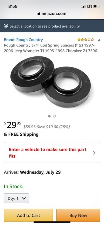

You’ll only need one of them, and it says Jeep, but they fit our trucksed49ba43d6a72f6b13d18889d88bc53b.jpg

Those measurements are in line with where most seem to be. Rear on mine at 60K was sitting at 39", had to add a 3/4" rear spacer to get it back to that 39.75".
