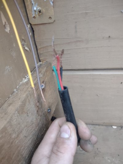

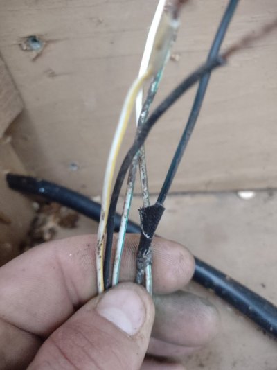

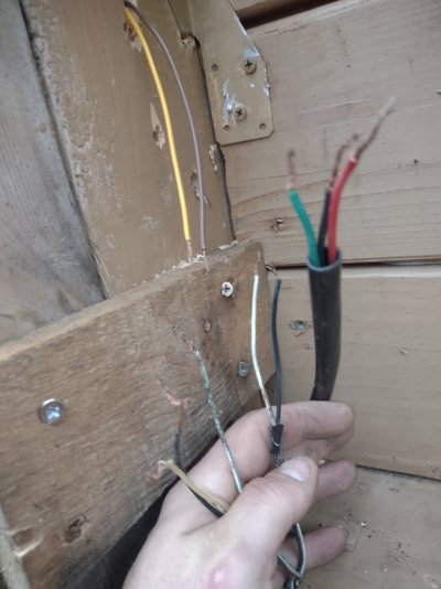

have a 2007 dodge ram 1500 with a new rear tail light installation for my custom built bed I bought 2 lights per side from O'Reilly's one has 3 wires and 2 bulb the one where tailer lights with 2 wires I have 5 wires coming from my main harness how do I configure this to work

Start out with a test light and determine from the truck side what is tail lights, and right & left directional, and ground. Test your new lights with a battery, or a jumper wire after you figured out what each wire from the truck does. The two wire lights are just power & ground, where your 3 wire lights should be tail, turn, and ground. Your new lights should also show what color wire does what.
