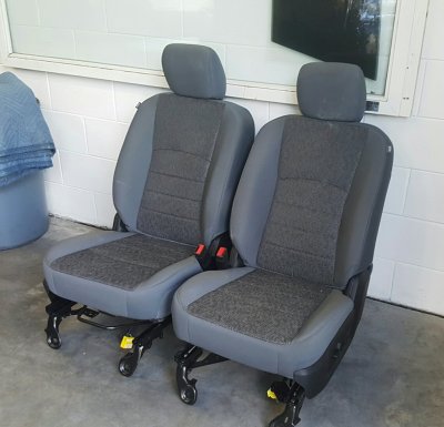

So, I got my new seats today.
Out of a 2017 Bighorn with 4000 miles on it.
I love the upgraded cloth and...POWER DRIVERS SEAT WITH LUMBAR ! :Big Laugh:
Now I am patiently waiting on M² Mods to finish My harness.

Now all you need is a truck to put them in! :p
Glad you to them. My '14 Big Horn has the same seats and I will admit they are comfy!

So these seats and the harness will give you heated and power seats? Would love to do this in my 2015 Express. If I can ask, what is this whole upgrade costing?

His seats will only give him power. If you are interested in adding heated and power seats, check out the 4th gen DIY section for complete details on what it takes. Depending on the seats, it can get to be a pretty pricy mod.
