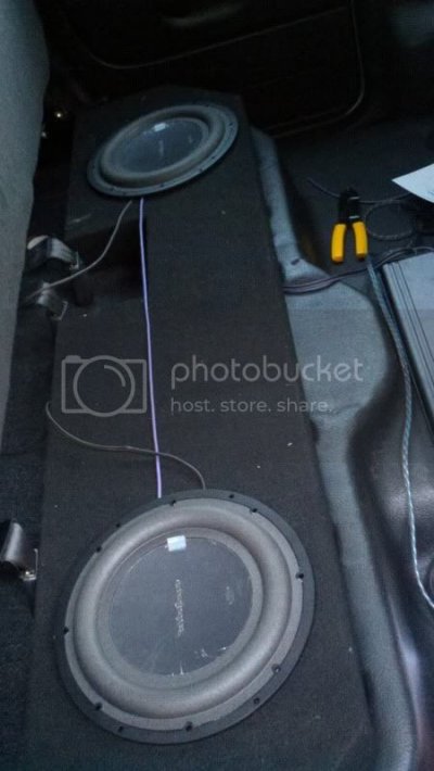

sweet, but why are there wires running outside of the box like that?

tHIS ^

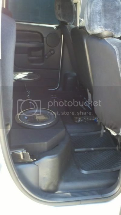

Third tucking the wires and you might wanna stash your amp under the drivers seat. With it sitting out in the open theres a high chance of someone sitting in the back smashing it.

the subs are DVC and my amp is a monoblock...i had to parallel the two subs and couldnt run the wires through the actual box...soon when i have time ill see if i can figure a way to run the wires inside (i hate the way it looks with those wires outside too)....and the amp will be fine back there, i never have people riding in the back, 90% of the time im riding by myself or with my GF in the passenger seat...i had the amp under the drivers seat but it would get ridiculously hot there...its safer in the back

is it 2 sealed portions? If so, drill a hole for the wire to go through and then use some silicone to seal it up.

Yea its two sealed portions, the thing is that sealed portion of the box is about a foot into the center..unless I have a real long bit I won't be able to drill, and once it is drilled getting the wires in the hole would be a pain unless I use a coat hanger...hmm maybe I could do it.

Properly mounted subs would have demolished that speaker wire, imo get new wire and add wire ports. Dill holes the exact same diamater as the wire!

yea the subs aren't mounted all the way just quite, i'm trying to figure out a way to run the wires through the box or the outside where its not coming out from the mounting area..i think I got it though
