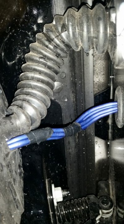

The best way I found is to run a wire parallel to the accordion sleave. There is a plug either just above it or just below it to run wire through. It is much easier then trying to get that boot off.

^^^Just like this...you can protect it afterwards with wire loom.

Yeah I covered mine after this pic was taken just didn't have a pic of it covered with the wire loom.
I did go through the factory boot on my 2004. I had to drill out a few of the unused holes in the molex to make a hole large enough for the speaker wire and then used a metal coat hanger to pull it through, huge PIA but can be done.

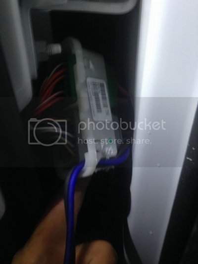

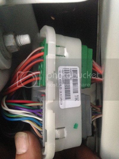

Pull the boot off. Press the two locks on the top then then two on the bottom and the connection pops out.
I had to trim the corner off to get my wire to go through. If you're running a smaller wire it'll go through.
Unscrewed the boot from the door and removed the plastic cover the fed wire through
Then reassembled

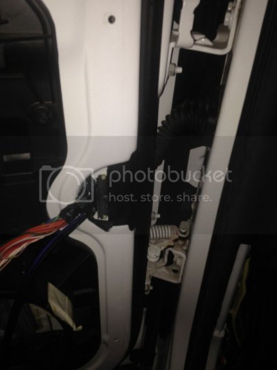

Took about 20 minutes a door
On the front driver door you can reach over the park brake and get to the wire.
The backs are a little tougher to get through the boot. I fed a zip tie through then pulled the wire
