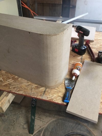

Been meaning to take more pictures throughout this but here’s what I have so far. I’ve been tired of under my back seat being taken up and not having much bass in my truck. I’ve been contemplating a center counsel box for a while now and just now building it. Specs are going to be about 1.25 cuft tunes to 39 hrz. More pictures to come.5e0bf1cb372f0e05b8c1a55564b82c8c.jpge8f38875e67c6d0e23fa9577695a3b3c.jpg73e33fbe031a2fd80bbab5d5caeddf94.jpg

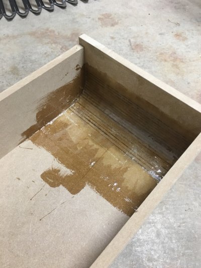

Fiberglassed the inside of the kerf tonight got home late from work tonight and the past two nights so not much progress. I may change my tuning frequency to 36 hz. Might be re using a port tube from a previous box that I had in my Dakota
