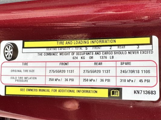

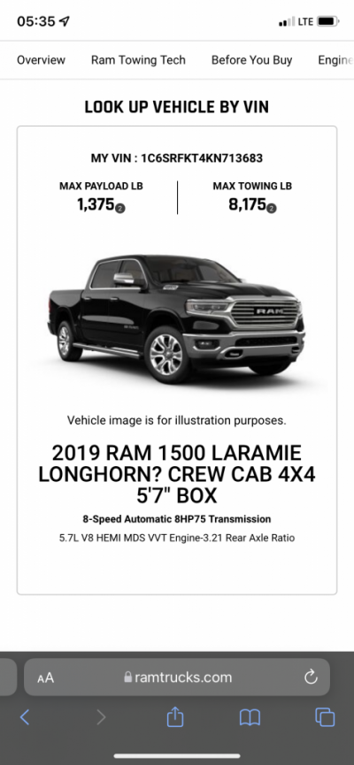

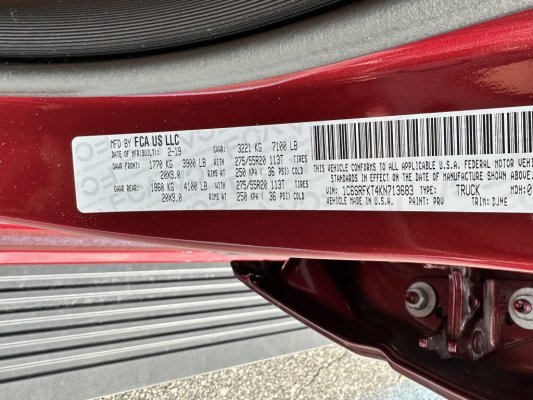

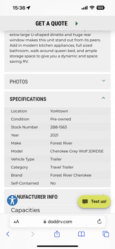

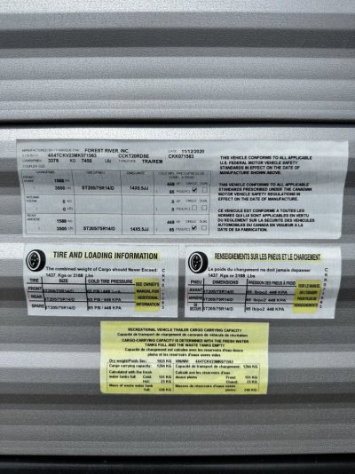

Me and the wife are considering a Travel Trailer. This is a first for both of us. Been watching a ton of YT videos, talking with current owners and poking around on RV lots. I currently drive a 2019 Ram 1500 Laramie Longhorn with air suspension. I am attaching some info on the kind of rig we are interested in. It’s going to be a while before we purchase. The attached pics is from a rig we like. Can the truck handle it?? I think she can based off what I know already but what do you experienced folks think. Good or bad.
I have the towing info from Rams site using my VIN attached and also the info from the dealers site and travel trailer itself. It would be me, wife, kid and 2 border collies. The family comes in at 520 lbs. Gear would come in at 500 lbs.

Looking at your numbers in pounds, the trailer has a dry weight of about 3400 pounds and a loaded weight of about 7500. At the upper end your hitch weight will be approximately 1100 pounds when properly distributed and estimating 15% of total weight on the hitch.
Your truck has a payload capacity of 1376 pounds, subtracting the 500 pounds of people you are at 876 payload remaining. The hitch and bars are about 100 pounds, so payload now down to 776. Not sure what the gear weight of 500 pounds is, but assume that is for the camper. So the remaining 776 payload capacity means your trailer and gear needs to come in at 5200 pounds.
You should be able to tow the trailer but you need to remember dry wright does not include propane tanks or the LPG, the house battery, or any options added on by the dealer (check the sales sticker). So adding tanks, battery and water is about 500 pounds. Your gear is another 500 pounds (should weigh it as it adds up faster than you think) so dry weight of 3400 plus 1000 pound gear and listed items gets you to 4400 gets you to about 660 pounds tongue weight, leaving you about 116 pounds of payload capacity to work with (776-660=116). You'll read about people who stay below weight religiously and people who go over and never had a problem. In the end, you and your family are the only ones in the rig and keeping within specs just helps mitigate risk.

Assuming you have no aftermarket truck addition, your vehicle weight full of all fluids including fuel is your GVWR - payload capacity. The math for you in pounds is 7100 - 1376 = 5724 pounds truck weight. So if you do fill up and go weigh it, put everyone including pets, hitch and bars, and all gear that you would have in truck and weigh it that way. You then take that total and subtract it from the 7100, this will give you your max payload remaining. Take that number and multiply it by .15 (15%) and the result is the maximum trailer weight you should tow. This assumes you have gear properly distributed in trailer.
For the trailer, my last post already stated some weights above dry you should already expect such as propane/tanks, battery, and any dealer accessories. You could get a weigh-safe hitch that has a scale built right into it. This would measure tongue weight every time and, again, if you properly distribute weight that should give you a fair estimation of trailer weight (that 15%).
