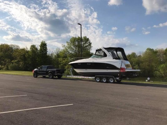

I had a ‘14 2500 crew 6.4 4.10 gears. I pulled a 33.5 ft cabin cruiser with it. I was close to 16k lbs when it was loaded up. Truck didn’t complain once.
