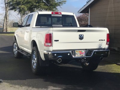

I'm about 99.9% that the 20x9 stock wheels are +19. Perhaps the air-ride is different, but I'm pretty sure it's not. I bought an aftermarket set of wheels for my non air-ride Eco Diesel and specifically got 0 offset because I wanted a hair wider stance but didn't want to clean the side of the truck off every time I went through a puddle.
