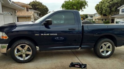

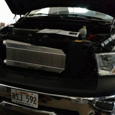

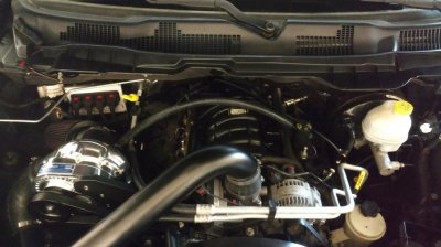

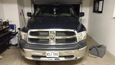

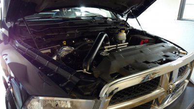

Hey all, just figured I would finally join up with a forum instead of lurk. Earlier this year I picked up a 2012 RAM 1500 5.7 reg cab 4x4 to haul my dog since my boosted M3 wasn't really dog friendly. Well since selling the M3 earlier this month and being without boost I pulled a trigger on a D1SC kit from ProCharger. Still very much in the build phase and still my DD but right now she is rocking the D1SC, step colder plugs, waiting to install my 90mm TB and JBA long tubes/3" Y-Pipe to magnaflow exhaust. Most definitely impressed with the driveability and the power gains from the S/C and canned tune but it is definitely time for a dyno tune. Unfortunately until I leave Hawaii I think I have to wait for a better individualized tune:

As far as procharger goes, I would say about 90% of the kit was spot on and I was incredibly happy with it. However there was some disparity between some of bracketry they sent me vice updated parts in their inventory. There is a sub bracket that fits to the passenger head that allows the main S/C bracket to line up to the rest of the pulleys on the engine. I had mine powder coated and when they cut the threads into the aluminum bracket they didnt run them all the way through, thus when threading the bolt through she bound up, and trying to pull it out it snapped the bolt. Trying to drill out a hardened bolt out of an aluminum bracket didnt end well so I had them overnight a new bracket. It looked completely different although the mounting holes lined up fine. I bolted it up and finished the kit. I then could not fit the belt they sent, so I had to go find the last 2 belts on the island that were 1" longer. I then threw one of those belts and just destroyed it. Looking at the mounting of the main S/C bracket it appeared to be off just a tiny amount. After tearing the whole thing back down to parade rest, come to find out the new bracket they over nighted me was about 1/4-1/2" too thin thus threw off the alignment of the entire pulley assembly. I was able to repair the old bracket and put it all back together though. I was also missing some hardware from the kit, as well as having to build custom intercooler mounts as the way the designed kit works I was only able to align 3 of 4 mounting locations.
