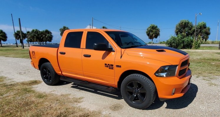

Thanks. I'm impressed. I'm really enjoying my truck. My Pops was a mopar man. All I ever knew of him owning. I had a couple of Dodge trucks when I was younger. Talking 318 days. My first Hemi. I'm enjoying all the information from all of ya'll. I'm on a 18 wheeler most of the week and only drive the Ram on the weekend. This past weekend I got on the freeway around Mobile. First time on the big road with it. I decided to dig into it a little bit and it took off. I thought that I was in the passing gear and it shifted again and for real took off. No hesitation or lag. Straight to the get up. Yes, I'm very impressed. 20240823_101940.jpg
