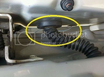

3m tape and i grounded them on the mirror mount bolt and ran the + wire throught the rubber boot between the door and body and then through the inside of the fender and to the blinker

thrers the door jam, i ran it through the rubber boot into the cab and out the rubber cap behind the boot

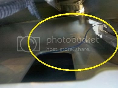

then into the fender
then spliced it into thr green blinker wire.
