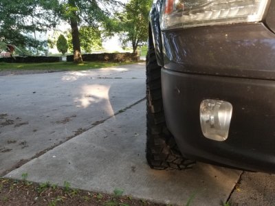

Well for my 4th gen I believe stock is 19mm positive offset. I am running a 0mm offset rim currently and it sticks out about less than a 1/2 inch if I would guess. Should be about the same for 5th gens I would guess.

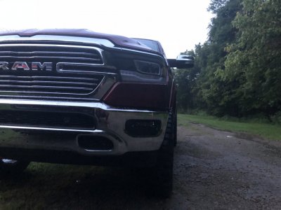

-12 offset
Blue Streak Pearl off-road

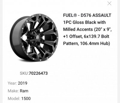

richnieveslv
richnieveslv
Sep 24, 2018
20
Las Vegas
Ok CARiD.com recommended this wheel size on their website with the wheels I want. These are +1 offset and another pair I was looking at were +18 offset on their site. Do these measurements look right? How much will these wheels stick out?
