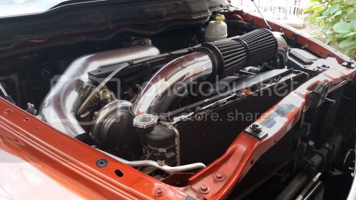

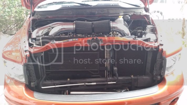

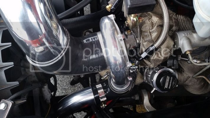

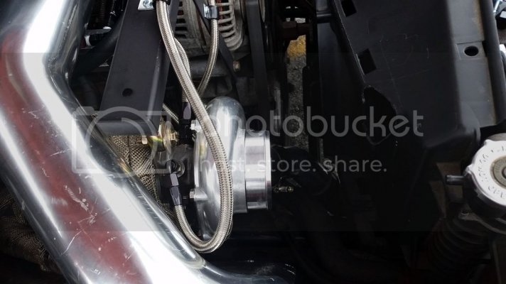

I installed the air filters. They sit about 2 inches away from the hood scoop opening
I already know how i am going to enclose the filters, i am just waiting for some 6inch aluminum tubing i ordered to show up. I did some more of the cold side today as i received the missing couplers, but forgot to order some 3"t-bolt clamps so i could not fisnish. I then move on to the exhaust. I took the truck to my friends shop as he let me use on of his lifts to work on that. I used dual 3" tubing (one form each downpipe) merging onto a single 4". I did not take pics because i finished very late, i was tired, and i honestly i forgot :-D , but to give you an idea, it follows the same path as the oem tubing, just a little bigger and with vbands. I will try to get under and take some pics tomorrow.
I have yet to decide which muffler to run or how to route the tailpipes. Though i can tell you that i would really like to reuse the Daytona/Borla exhaust tips, but we will see.
As always, a few pics. These are from before i went to work on the exhaust
