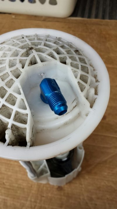

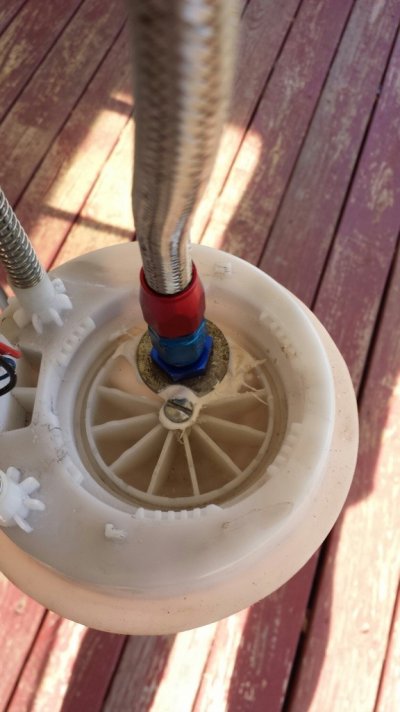

Your fuel basket is right on the money with the return line dumping directly into the basket. I also used his thread for guidance but didn't think I could mount both the pickup and return fittings into the small area so drilled the tank and routed a hard tube to dump into the basket. I like yours better.

I had to dremel away some of the "ribs" that you see to the left of your fitting in the pic you posted to make a little more room for the other fitting

I see what you did now. I stayed within the cast ribs. I should have done what you did.. Well done.

I have the same problem with AN fittings, I have a tonne of them but they are organized in a tackle-type box. You ran your fittings similar to mine except I ran a -6AN and a -8AN and the -6AN is run through the oem spout hole where you have yours blocked off. I'm pulling my tank tomorrow to install the 2nd pump so I'll snap some pics of it.

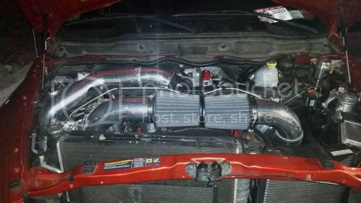

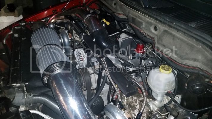

Not much of an update, but i finally finished the cold side! 20160109_171655_zpsdmxskkym.jpg
Will try to do fuel system next week
