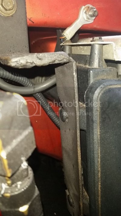

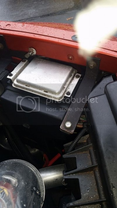

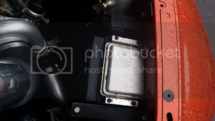

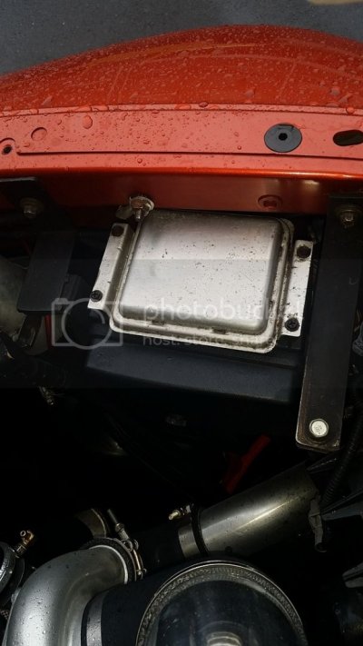

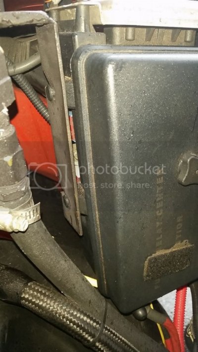

Here are the pics. I know the brackets look a little rough :D but the idea all along was to redo them in aluminum once spring time comes
Anyways, one side, is just an L bracket. The other side has a little more complex twist (nothing dificult at all) as i wanted to reuse the factory mounting points. 20160110_102314_zpsz5qmous6.jpg

Thanks for those pics. I think I'm going to just turn mine 90 degrees but leave the lid facing up; with the battery tray removed that open up a LOT of space.

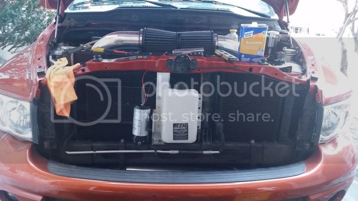

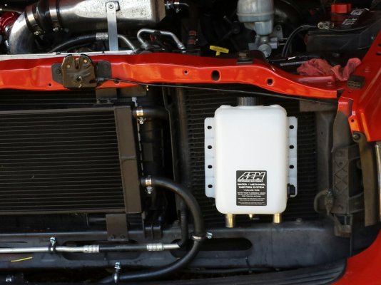

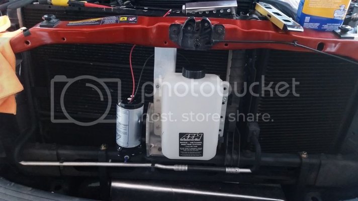

Not much new. The snow has set me back a little. All i was able to do today was mount (not wired) the water/**** tank and pump. Everything will be black. The bracket, the tank, the pump. I dont want it to be visible once the hood is closed. Tomorrow i have to figure out the boost/vacuum signal situation, i need 8 ports!20160130_153741_zpsflmquy6e.jpg

Haha my plan is very similar...
