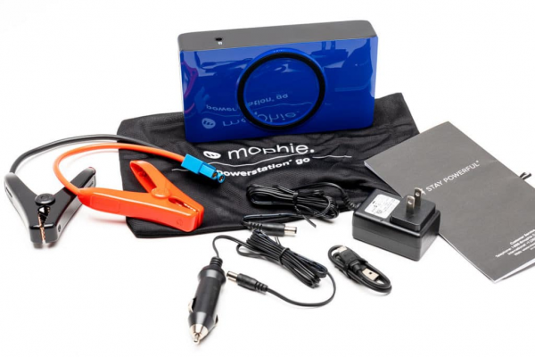

I agree with all said above but want to add a bit about booster packs. Since most have on/off switches the issue with sparks is irrelevant because you can connect the clamps then energize the lines to jump start. I have a Schumacher and it works great. I also carry jumper cables and it is so much easier to use the booster pack than to uncoil the cables and put them back up. As a bonus my booster pack has USB, 12v and 110 volt capability so I can use it for many other purposes as well.
