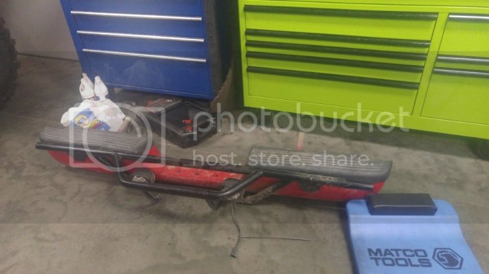

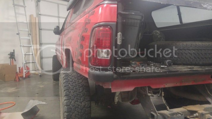

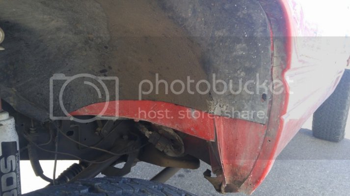

So, comp cut went alright last night. I've decided there is no avoiding it, the hitch HAS to come off. It looks ******* ugly, even with the rear runner mounted.
But, it's done, there's no going back now. I've decided I'm going to probably get in contact with Fusion about getting a rear bumper custom built. Just drop the truck off with them for 2-3 weeks and pick it up when it's all done. It looks good, but there's a bunch of reinforcements and brackets that I'm not in the mood for cutting off and welding up just for this.
I've also decided I need to go lower with the bumper than the A-Bomb. If I was running a similar front bumper to what Mercenary Off Road builds for the 3rd gen, then the A-Bomb would look good. But my Fusion hangs down lower than a real "high clearance" bumper so now the ass end of the truck is way higher than the front body wise.
So what I'm thinking, is a similar idea to how the front is. Back at the wheel well have the bumper drop low, then curve up to a thin all the way back and around towards the center of the rear of the truck. I'm going to order in a different rear hitch, one of the "no show" hitches where it's just the actual receiver that's visible under the bumper. That way I can try to keep as much clearance in the back as possible, but not lose the functionality of a truck. From there, I'll have it come down just like the A-Bomb does where the license plate would normally go, and contour to hide the hitch, then back up.
I've drawn up some fancy pictchas to show what I'm talking about at the end.
But here she is! All hacked up!
REAR BUMPER OFF
MY NEW DESK PAPER WEIGHT
OH ****. IT'S...GONE
PASSENGER SIDE
DRIVERS SIDE

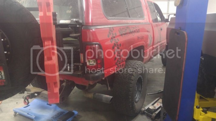

EXHAUST CUT AND DONE FOR THE NIGHT.
Somewhere during the bolt purchasing process I wound up pulling one 3/8 nut and one 7/16 out of the bin so rear runner couldn't go on...plus it was almost 2:00am
REAR RUNNER INSTALLED

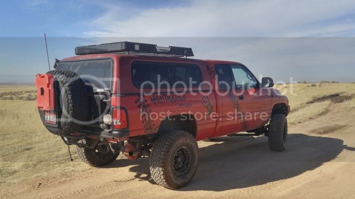

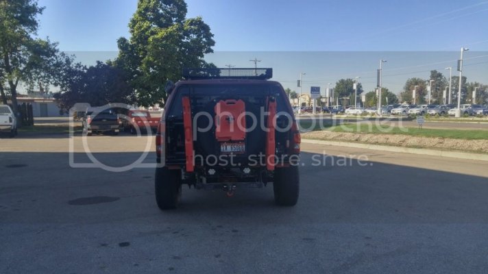

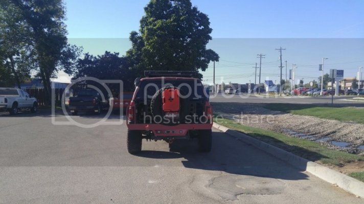

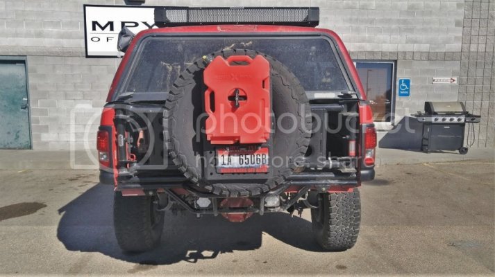

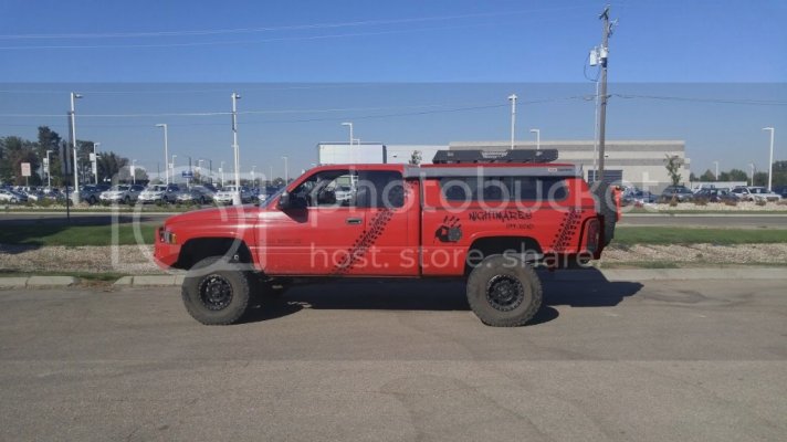

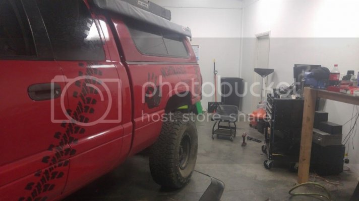

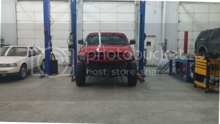

Alright, still gotta pull the shell off but I'm done dinking around with it for now. Got the hitch off, tucked away the trailer wiring into the frame rails so it stays safe. Got the drag link adjusted to straighten the steering wheel out, got the fender liners trimmed way up so the tires won't catch them again, and I finally got my JKS Flex Connects installed. Had to run a couple errands for the shop and man it's a night and day difference surprisingly.
With the sway bar disconnected the truck rides comfortably, but it likes to wander around. With it connected, it rides smooth and straight, but it does have a stiffer...feel to it. With the Flex Connects, it actually rides like a disconnected sway bar, but it holds its lane. Took it through a construction zone that's fairly bumpy, and I can let go of the wheel and it stays centered on the road. Pretty great.
Another truck was on the lift and I'm getting lazy, don't wanna lift the shell off the truck so plan is to back it up to the lift, slide some 2x4's under the shell once I get the clamps removed, and just use the lift to pick it up off the truck. I'll get it moved over to our bull pin Monday.

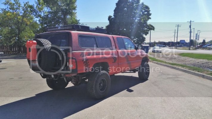

I gotta say though, removing the hitch really helped it out. Looks a lot better now. I reinstalled the bolts and nuts back in the frame rails so I won't lose them, and whenever I need to tow something it's only about 15 minutes with an impact for reinstallation.
But anywho's, here's some el photographo's

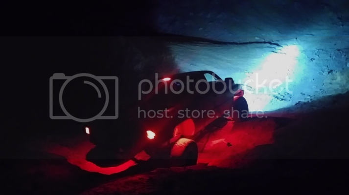

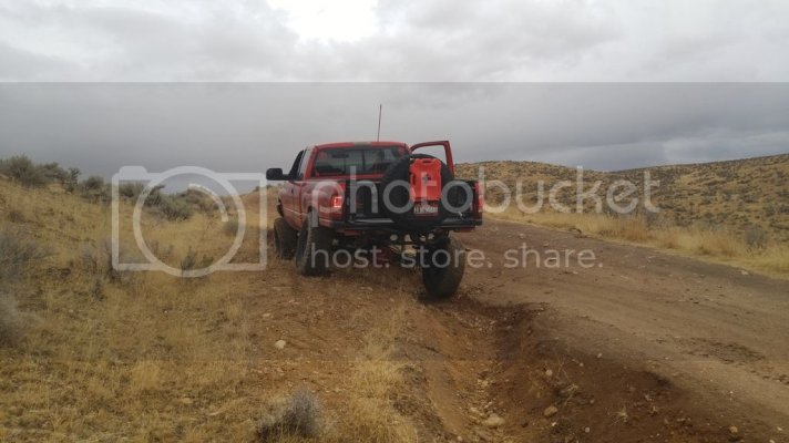

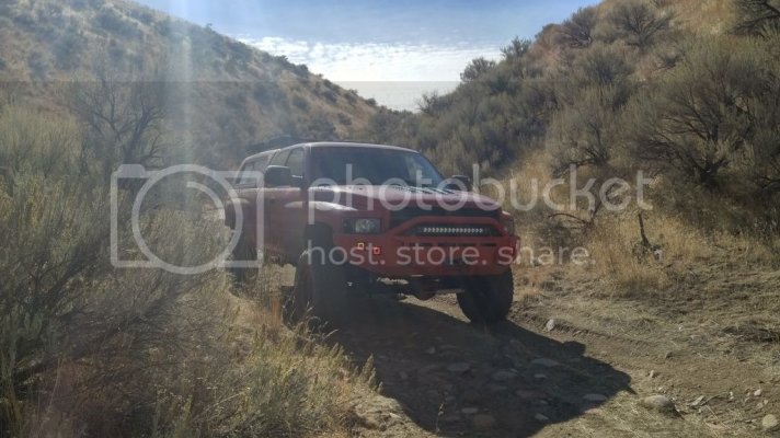

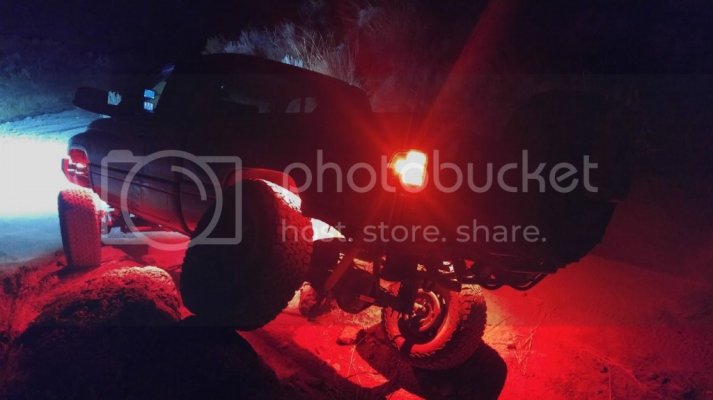

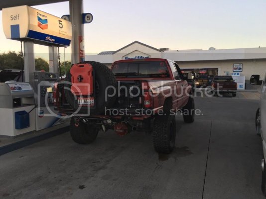

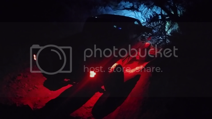

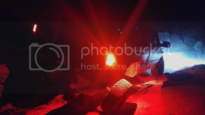

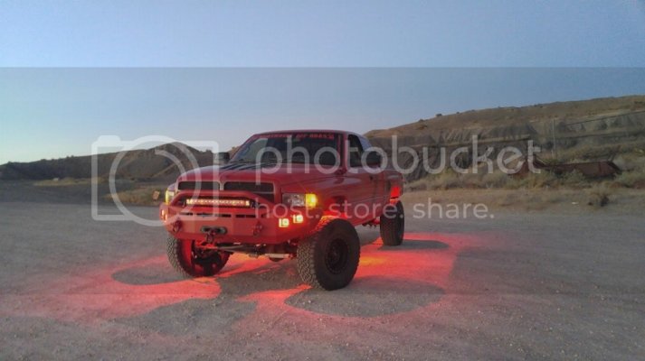

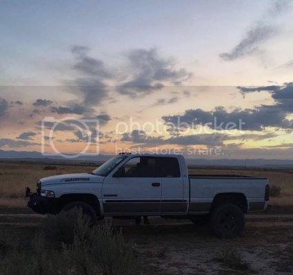

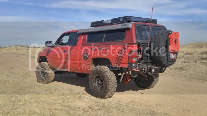

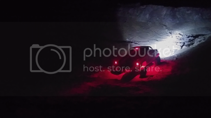

Alright so I finally got some photo's sent over from Labor Day run. Nothing exciting, but it's pictures none the less.
Took it out Saturday night for some night wheeling. Pretty cool stuff.

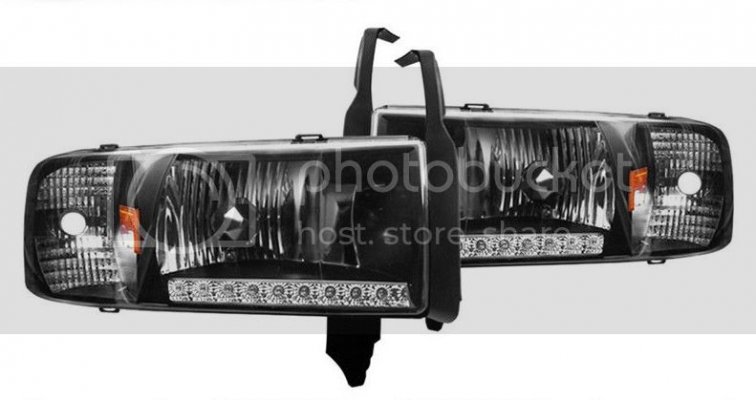

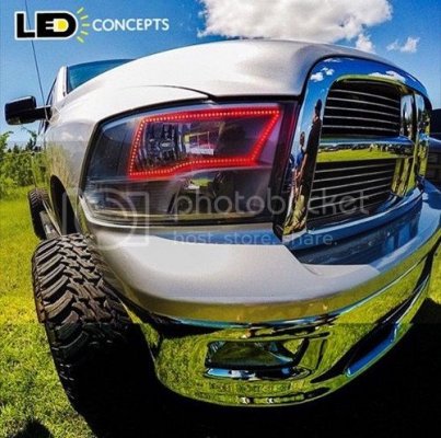

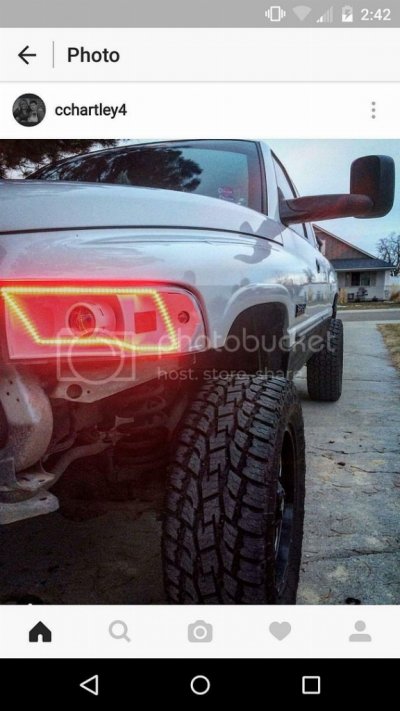

So small update related to lighting. I got an account setup with LEDConcepts so I went ahead and ordered in a whole slew of accessories yesterday, and a few more today. No account with Morimoto, so I've only got 3 items coming from them for this build.
But here's everything step by step.

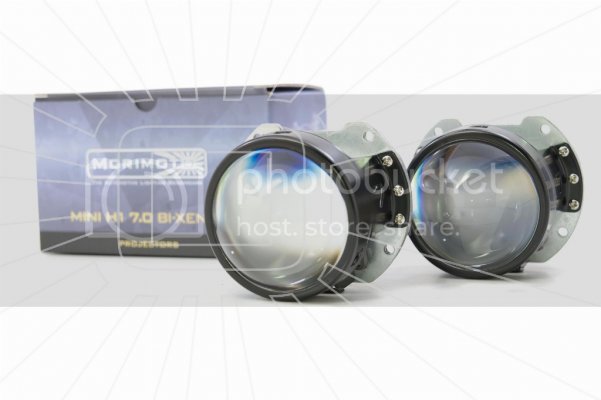

First off I'll need new housings for the main headlight halo's. Instead of doing the traditional square, a 2nd gen on Instagram that's local around here found by Riley of all places gave me inspiration for doing something different. So these are the headlight housings I've ordered in...again. These are the same as the ones I originally put on my truck (back on page 1 of my build) that are now long gone, so yay for another set.
Housings will be disassembled and everything painted black. There's a small section that separates the signal from the headlight housing that I'll paint red, but the rest all black.
The LED's across the bottom will be removed, and the small amber reflector in the signal will also be removed. Both will be replaced with something I'll list down below.

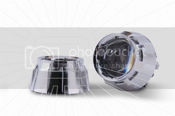

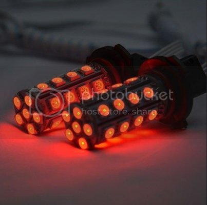

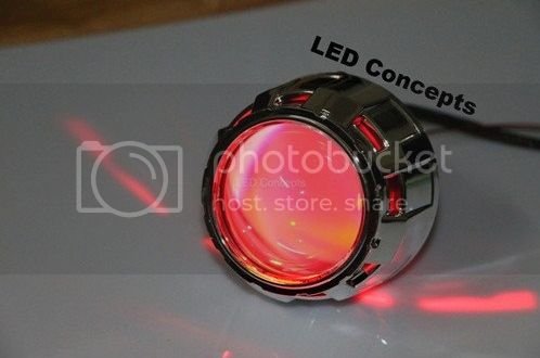

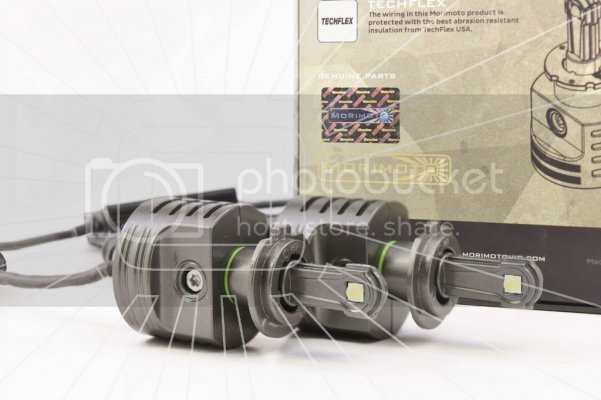

Doing a retrofit, so Morimoto Mini H1 7.0's are required.
To go with the projectors, I'm doing the traditional Gatling Gun 1.0's with them. Shrouds will be painted red.
I'm a giant fan of LED which is fairly obvious with the truck, and am actually pretty anti HID's. Morimoto has just released some H1 LED bulbs, so those are going in rather than some 6500k HID bulbs.

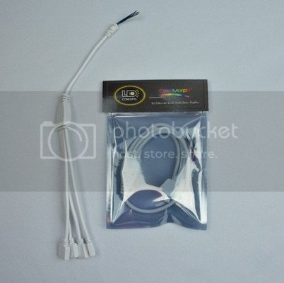

First item of the customization is controllers. I ordered in 4 of the colormorph controllers and receivers, along with single splitter (turns one controller from 4 accessories to 8). Each controller includes a single splitter, but one of these I want to run with 3 total items per headlight, requiring the splitter to go with it.
From here, this is where the real customization starts. As stated, instead of traditional halo's, I'm going to install a set of 4th gen halo's into the housings. These are wider than the headlight section of the 2nd gen sport housings I have, so 1 piece headlights are required for this.
Here's a shot of them in that 2nd gen. Based on this picture, fitment wise should actually contour perfectly with that small LED strip across the bottom of the housings so it should actually look even better than this.
Next will be the traditional halos around the projectors. These will be ran with the 4th gen halos, taking up one of the controllers. (Picture shows 2 halos', but each headlight is only getting one)
Next up are the demon eyes. Pretty self explantory, they illuminate the projector to whatever color I choose.

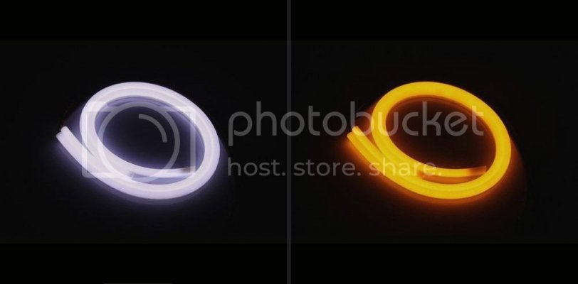

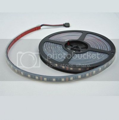

From here, a little more customization. I ordered in a roll of LED's, which I plan to stick around the backside of the housing to create a backlight. These will be wired in with the demon eyes, taking up the 2nd controller.
Since we're going full custom on these, I decided to eliminate the traditional turn signal bulb and replace it with more backlight. I ordered in a set of the colormorph fog light bulbs that I'll trim to fit into the slot for the turn signal. This is where the splitter comes in, as I'm going to run these with the demon eyes and LED strips, which basically will make the entire housings glow.
Now, since I'm eliminating the turn signal from the corner housing, I have to do something, right? So I ordered in the sequential LED strips that I will use to replace the narrow section across the bottom of the headlight housings. They glow white, and when the signal is activated they'll "flow" amber from left to right. Because of the design on the 4th gen halo, I'm only going to do these across the bottom of the headlight section, then tuck the excess back behind the signal section (headlight and signal are 2 physical separate sections even though they're one piece housings). I know the LED strips that I'm using for backlight are able to be cut and soldered every 3 LED's, but I'm not sure if these sequential's are setup the same. So the excess behind the signal might get wrapped in electrical tape or something to keep it from glowing behind the housings and ruining the look.
Since the sequential's are only going across the bottom of the actual headlight housing, I need something that will tell those next to me that my signal is on. I spoke earlier about removing that amber reflector out of the signal portion of the headlights, in replacement of it I'm putting a 6" colormorph uber-flex strips in there. Since they're flexable, I can form them as a rectangle in replacement of the reflector, and hooked up to the same signal source as the sequential's.
Since we're doing a bunch of backlighting and such, I've decided I'm going donate some parts off this truck to my new daily driver (not the Bronco, I'll explain more after I get through this). I'm getting rid of the Rigid SAE's and spot dually's, and have decided to order in 2 sets of the new Rigid Radiance Pods in red. These I will disassemble, and install another set of the pod halo's into them. What this will do, I can flip the backlight on and the housings will glow red, and I can set the halo's to amber. The headlights will be setup the same way, red backlit housings with amber 4th gen and projector halo's.
These 4 halo's will take the 3rd controller.
Last item on this list is the Radiance already on my bumper. To match the POD's, I'm doing a 30" halo inside the radiance. This will take the 4th controller, and leave me with the option for 3 accessory's for accent lighting somewhere else on the truck in the future.

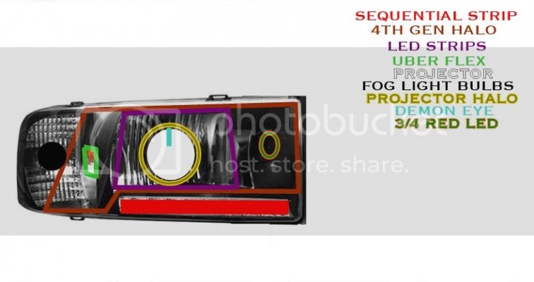

Basically for driving around during the day only the little white strip across the bottom will be lit, which will also stay lit up at night as well. When I turn on the park lights, the halo's on the Radiance Pods will light. When I turn on the headlights, headlights will come on. And when I pull the switch for fogs, the headlight halo's will light up. All the halo's will be set to amber all the time, so no real need to keep the remotes easily accessible so into the glove box they'll go.
Turn signals will be the sequential across the bottom, and the small rectangle in the signal section.
The 4 switches on my Edge CTS2 will give me control over all the accessory and off road lighting. Switch one will turn on all the red glow on the headlights, which is the led strips, demon eyes and the LEDC fog light bulbs that replaced the turn signal bulbs. Switch two will turn on all the the red glow on the radiance lights, along with the rock lights under the truck. Switch three will turn on the halo on the 30" light bar, which will again always stay on amber. Switch four will turn on all of the forward facing off road lighting, which is the 30" light bar and the rigid dually's.
Here's a quick sketch that's labeled to show where everything will go.

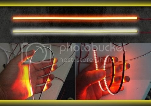

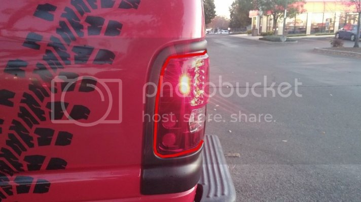

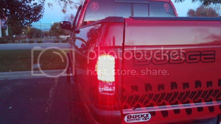

Tail lights are also getting some upgrades, unfortunately at this time I couldn't order the items as they're on backorder for a few weeks.
I absolutely love my tail lights, my ONLY complaint is at night they do not emit any light to the sides. Without park/headlights, when I hit the brakes or flip the signal, the entire tail light lights up which those next to me are able to see that I am stopping or turning. But during the night, the top row, outside row, and lower row light up on park/headlight forming a C, and the center section is the brake/signal.
So, disassembly is step one. Plan is to get the sequential 24" strips just like what I used in the front, except getting them white and red. Plan is to imitate the current F-150 with a tail light halo sort of say. Basically around the housing I'm going to wrap the sequential strip strip forming another C, then put the red lens back over them. When I turn on the signal, they'll flow around the tail light. When I hit the brakes, they'll flow to a solid state (like the new mustang brake lights do) and then flow back off when I release the brake pedal. The will not illuminate with park lights, only when brakes or signal is activated.
Before installation of the strips, I'm going to get some red film and wrap the strips in it. From there, I'll wire in the "white" part of the light to the dome lights to imitate the 3/4" flush mounts in the headlights. With the red film wrapped over the strips, and the red tail light lens placed back over the top of it, they should appear red. Worse case scenario they wind up being a little pink...But I don't think that'll be an issue. But yeah, when I hit the unlock on the fob, the tail light halo's should illuminate red as well. I think it'll look pretty cool.

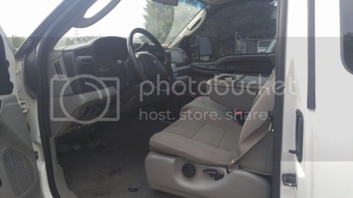

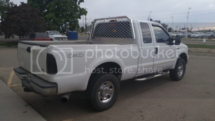

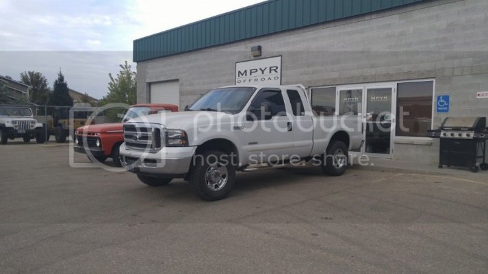

I picked up a new shop truck and daily driver instead of using the Bronco or Dodge. Got a 2005 F-250 with a bullet proofed 6.0 in it. Nothing special, extended cab short bed with some black headlights and black led tail lights. But under the hood had 16k worth of work done, including head studs, exhaust, injectors and upgraded turbo, all done 2 years ago and less than 50k since the rebuild, the entire truck only has 155k on it.
This truck will actually stay fairly basic. Already got a 4" rough country lift kit coming, have a set of 35x12.50x20 Nitto Exo Grapplers for it, and am trying to find what wheels I wanna use. Only real upgrades other than that is going to be some Fusion bumpers front and rear, no winch, no light bar, just my dually's with the halo's I'll hook up to the factory aux switches in the truck. Headache rack is for sale, bed caps are also for sale unless it takes too long then i'll just scrap them, going to put some bushwacker plastic caps on it. Then black badges and just call this truck done. Performance is already done, the only other item I'm adding is another Edge Juice With Attitude CTS2 which was actually on the truck before the dealership got it.
Wound up picking the truck up for 7k, needs a FICM which runs anywhere between 200-300 bucks. Only issue is sometimes it acts like a failing neutral safety switch, turn the key and no response. Pull the starter relay from under the dash, pop a paper clip in and it'll fire right up. Pretty sure it also is an XL with XLT badges, as it has power windows and locks, but the power accessory panels are a different shade of black, the switches are the 99-04 style and are different than a lot of the 05-07 switches we see on the other trucks, it has power mirrors with the little heat emblems, but no switch inside the truck to turn the heat on and the power mirror switch doesn't work. The doors also have the holes where the manual window cranks would be, so pretty sure someone added the tow mirrors and power accessories to it. Also, all the other badges and emblems are faded, but the F-250 XLT badges look brand new.
But I honestly don't care. Truck runs like a ***** ******* ape, fits the entire family, and it was cheap.

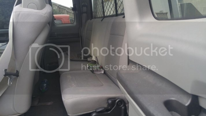

Here it is. In front seat photo you can see there's no lower dash panel, but in the rear seat photo you see it sitting on the seat. Until the new FICM gets here, I've moved the panel cover to my office in the shop just in case it doesn't start up makes it easy to reach down, pull the relay and jump it.

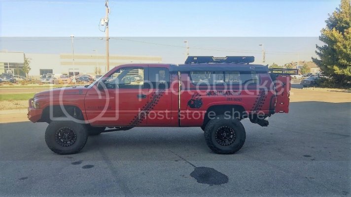

So with that said, here's the plan.
Pretty simple on the exo cage. Connecting at the front bumper, it'll run around the wheel well on the front fender, run down the rockers as a slider, run around the bedside wheel wells, and wrap around the backside as a bumper and replicate on the other side. For the cage, it'll run up the fender, over the hood, up the a-pillar, across the top of the cab and back down between the cab and bed, connecting onto the slider. For the bedside, it'll connect back at that vertical bar and run across the top of the bed, wrap around the corner above the tail light, and connect to a 3/16” flat plate I'll mount between the bedside and the TireGate. Around the tail light will be a curved tube running from the upper bed tube to the wrap around on the bumper, creating the guard. Connecting the two sides will be done at the cab, which I'll have one tube going across the windshield, one tube going across the back of the cab up top, then an X centered between the two on top of the cab to add some rigidness to the build. I'm thinking of cutting a slit open in the tube above the windshield, and flush mounting a single row 50” Rigid light bar in there for some extra flash and functionality. If I go this route, then I think I'll figure out a way to flush mount some side lighting into the exo cage as well, and also weld on some tabs for some lower a-pillar dually lights. We'll see when we get there, it can always be added later on.

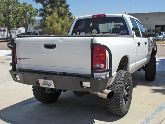

Rear bumper wise I'm scrapping the Fusion and just going full custom with it. Doing a tube style commonly seen on Toyota's and K5's, pictures will be posted down below as I'm not going to go into strong detail on that. Only add on is going to be the rear winch, which I'm actually going to incorporate into the rear hitch. Basically I'm just going to weld a 1/4” steel plate to the bottom of the hitch creating a floor, drilling the holes, the welding an upright to the backside for the fairlead to mount to, and a red Factor 55 Flat Link. From there, attached to the frame rails I'm going to add D-Ring mounts, and replicate the idea of the N-Fab but bring it down far enough to properly fill the gap between the bed and the hitch.

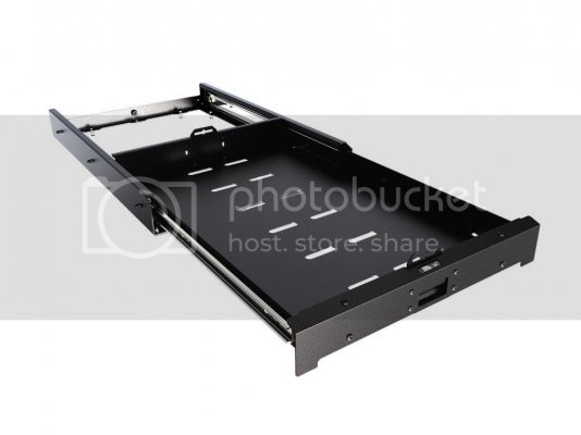

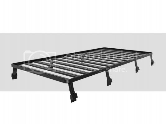

The All Pro Pack Rack is still getting built and installed, only I'm going to scrap the platform idea. Reason being, I'm going to make it so I can transfer the Go Rhino basket from the Pack Rack to the top of the exo cage over the cab, then just build a single platform for the rooftop tent. I'm also going to mount the ARB awnings onto the side of the platform, that way I can keep just the basket on the truck for general use, and when going on camping trips my entire overland platform can just bolt down with awnings, tent and all. I've come up with the plan for the sides of the Pack Rack, which is going to be pretty simple. From the center post back towards the TireGate will be 3 RotoPax black storage cans on each side. In the cab to center post section, on one side will be my Hi-Lift and below that will be my Smittybilt W.A.S.P. (land anchor) and on the other side will be a pulaski and shovel.
Paint wise will be a little extensive, and I didn't photoshop any pictures of it. But basically I'm going to start by priming and painting both the exo cage and the Pack Rack with some single stage black. Once it dries, anything facing towards the sides of the truck I'm going to raptor line red, and leave the center bracing of both the exo cage and the pack rack black. Rear bumper will go red, hitch and winch plate will be left black. Reason for spraying it all like this is, I don't want to strip and spray my TireGate red, and I don't want to strip and paint the Fusion black. All red is too much red, and all black will throw off the look it currently has. So I figure my plan will give it enough contrast, but stick to the theme.
Here's some photo's to end phase one.

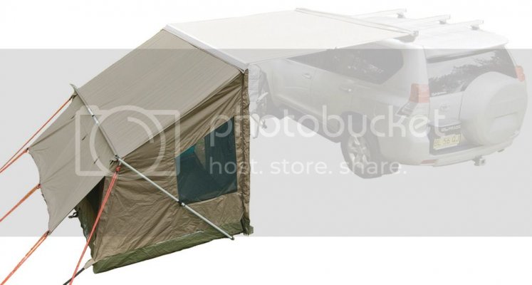

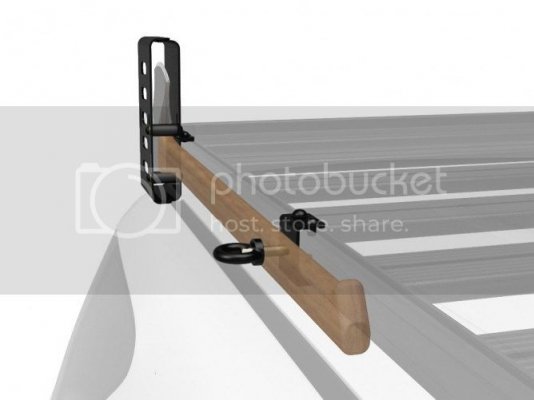

This picture shows the awning and a pulaski, but I covered where the awning will be already, and I'll post up a picture of the W.A.S.P. Down below.
Here's the wasp. Second picture is technically a pull pal, same thing different brand.
Here's something similar to the rear bumper I'll build.
I've already posted this picture here, but this is the idea for the tail light guards.

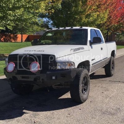

So no big updates to give for the Dodge right now as for what's been done. It's actually been sitting immobilized at my house courtesy of a broken idler pulley that took out the serpentine belt as well. Haven't found the time or the brought the tools home to swap it out, so just been driving the Suburban while the wife sports around in her new Tundra.
Had a scare about 2 weeks back. Mother in-law passed away on the 23rd of September. No life insurance, no savings, father in-law doesn't work, and once she passed her medicare expired leaving my wife and I to flip the bill for her funeral. Didn't have the funds available for all of it, so I threw up both my 6.0 Powerstroke for 18k and the Dodge for 22k. Dodge was the first with an offer of 20k from a guy in Colorado, after talking to his bank the most he qualified for was 17k which I told him to give me a few days and see what happens. Wound up selling the Powerstroke a few hours later for 16k.
I'm not going to cry about it, but I learned a lot from the Dodge being listed. People believe only ******'s are worth ****, even members on here had to voice their opinion, both on how the truck isn't worth my asking price, degrading my intellect, and quite a bit of name calling.
So, I'll limit myself on where I do updates for this truck, confined to this build thread right here on RamForum only.
As for updates, parts have for the most part all arrived for my headlight build, sitting in a box in my closet at the shop. Bed rack should be here next week. Still waiting on DOR parts, but not in a big hurry for them right now.
Couple larger updates regarding my plans for the exo cage.

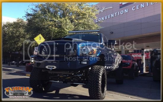

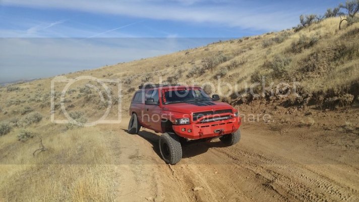

We have decided to donate the Fusion bumper off the Dodge to the Bronco, my Ram will be getting a tube style front bumper that will flow better with the cage and sliders. Rigid Dually's and halo's will all go to the Bronco as well, lighting for the Ram is getting very, very heavily updated.

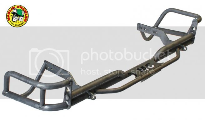

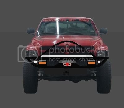

In the tube style front bumper, I'm going to in a sense replicate Fusion's idea of the stacked dual row 6" lights, only changing it up to a 6" single row on top, 6" dual row on bottom.
Here's the bumper for reference.

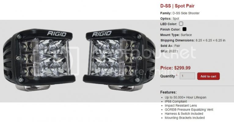

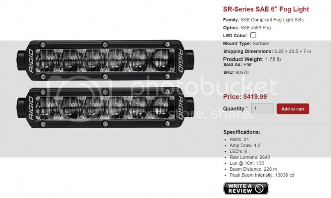

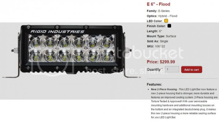

For the 6" lights, I'm going to use the new Rigid 6" single row SAE's. These will be hooked back up to my factory fog light wiring and used as they're supposed to. For the dual row, I'm doing the Rigid 6" E-Series flood in amber. The amber floods will help out immensely for night time snow wheeling or fog.
Towards the outside of the bumper, I'll mount some of the new Rigid Side Shot dually's in a spot pattern.

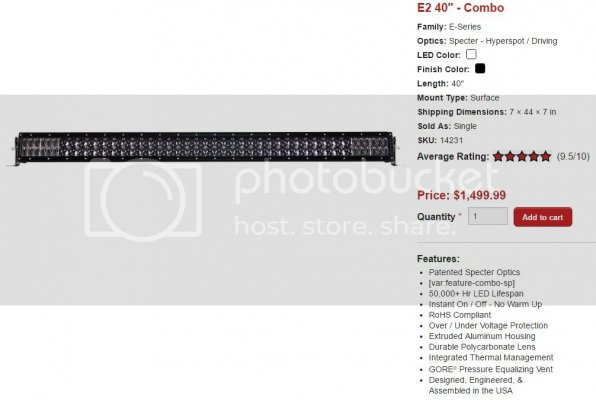

Across the top of the bumper I'm going to do a Rigid 40" E2 series combo bar.
And to top off the last of the updated lighting, I'll be replacing the red A-Series rock lights with some white ones.
As far as the bumper goes, here's a quick sketch of what I'm thinking. Tube style with the winch mount, dual 6" light buckets, floating spot lights, and a stinger above the hood. Below the lower bar/winch mount, I'll make a skid plate that runs down to the lower section of frame to hide the excess.
Here's a before picture of the photochop to kind of show what I was talking about with the skid plate.
As stated, the dually's and halo's are getting transferred over to the Bronco with the Fusion bumper. The 30" Radiance in red and the red rock lights are getting donated to my little brother for his 00 Ram. To replace the Radiance on the Fusion, we'll be doing another 30" Radiance, only in Amber instead of Red.
Speaking of my brother though, his Ram is coming together. He has a welding class in his high school where they actually cut down, straightened, and installed my old MOVE bumper onto his truck last week. He also got my old 3" BDS lift installed, and some 285/70R17 Toyo AT's for his truck to top it off. I gave him my red rear bumper last night so he can get rid of his smashed chrome one, which he'll be painting black and installing sometime this week. Truck actually looks really good.
1st picture was him mocking the lights on it asking what my opinion was, they've since been hooked up and aimed.
Other than that, everything else is going awesome with the other projects. Bronco is finally up to date on the plan of attack. Wife disagreed with a lot of my options, so instead she took over the build plan of it and gave me a list of stuff she wanted. We've settled look wise on doing a set of 17" Method NV Bronze wheels, some 33" BFG KM2 MT's, my Ram's Fusion bumper, and the front clip swap. Front end will be getting some stock fenders, I'll have some custom Bronco emblems made for the side. Hood will be the Raptor style hood, Raptor style grille with the 3 amber's across the top, and then all chrome headlights and tail lights with Putco LED's in them. Once everything is done body wise, we're going to paint the Bronco a glossy tan, then have some black MPYR decals with the skull and pistons right on the sides of the door, kinda like an old military look.

To start the overland build off, I would order in a Front Runner rack. Unfortunately for my plans with this, it's a lot of mixing and matching parts together for my application as they don't do racks that fit over the cab and shell. More than likely if I ordered all of this, I'd call them and see if I can just order in the parts I actually need so I'm not throwing crap away.
But, the rack itself would be part #KRLDT03L which is the rack for a Land Rover Defender 110. Dimensions are 56" wide and 109" long. It's the largest rack they have. Model name is the Slimline II.
Because neither my truck, nor my shell, have rain gutters, I'll have to order in the 50mm feet to go with it. I'd probably ask Front Runner to swap out the 4 pair for me. Essentially the rack would bolt down to the camper shell using 3 pairs, and over the cab I would bolt some rubber pads down to the bottom of the last pair so it's not bolted to the cab, but the weight is still supported and it doesn't bounce around.

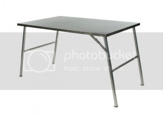

Stainless Steel Camp Table kit. Mounted so it would slide out the back side.

To relocate the Jack, I'd mount it driver's side above the camper shell.
To relocate the pulaski, I'd mount it passenger's side above the cab.
To add to my stuff, I'd get a red handled shovel (to match the pulaski) and mount it driver's side above the cab.
