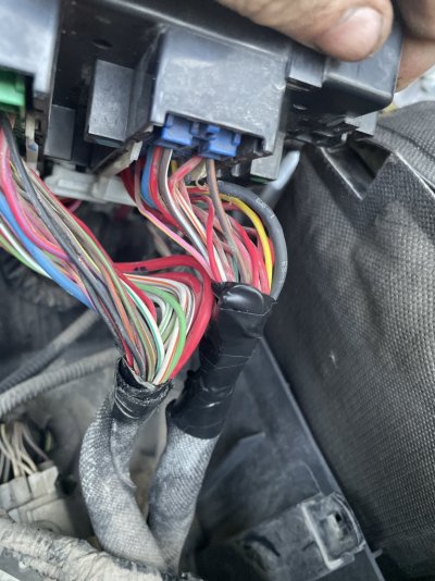

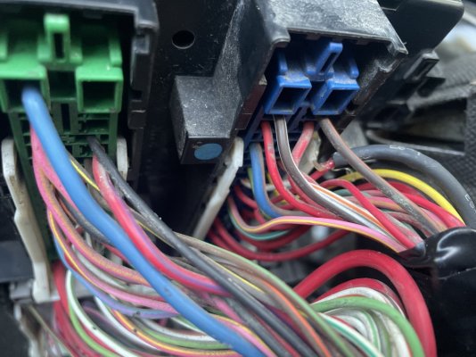

Well gentlemen I loaded ole girl up on the trailer yesterday and took her to the dealer last night and out the keys in the drop box. Called em this morning and gave all the info. They called me at noon and told me they would bring it in after lunch. Got a call at 3. Found the main ign wire coming from the bottom on the tipm was corroded inside the insulation and had broke in half. No way of seeing it! So 500$ later gained some valuable info about these trucks!

Will post pics of the bottom of fuse box and location of break tomorrow
