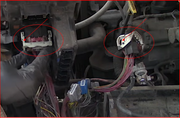

We don't know the root cause yet. Another contributor (Indept) suggested in a similar post, they had the same experience with a
CRANKSHAFT POSITION SENSOR​
r failure, that is a simple fix so I am going to replace that. Also I am going to lift the TIMP box and check the connector latches for unlocked position.
