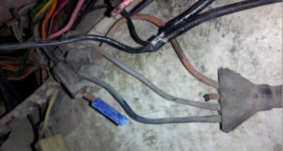

Should have voltage on both sides of that fusible link. I ran into something similar. Poke the fat wire with test light, the poked the 4 individual wires with the test light. First time I ran across a "fusible link". If you're not familiar here is a pic (one of the links has been bypassed). The links say "fusible" on them

Thanks for the input. I have an update for you guys. I found my problem, wasn't the fusible links, but it put me in the right location to find the problem. The black 6 gauge wire that comes off the positive of the battery rubbed on the inner fender. It had been corroding for some time. It broke apart not allowing the truck to start and when it made contact with the inner fender it blew out my low beam on the headlights, the dome light, the underhood light and one taillight . Thanks for the help and it's great having my old Dodge up and running again.
