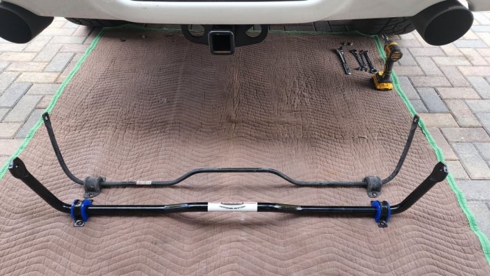

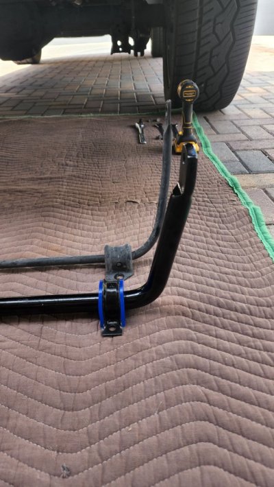

Here's the Roadmaster swaybar next to the stock R/T rear sway bar...
The Roadmaster bar came with heavy duty end links... I didn't install them as I will be lowering the truck 5" in the rear and need a shorter set of end links ...
It handles so much flatter ... but a little more squirrely ... it needs the heavier front Hellwig bar to even out the forces and keep the rear end from breaking loose ...
