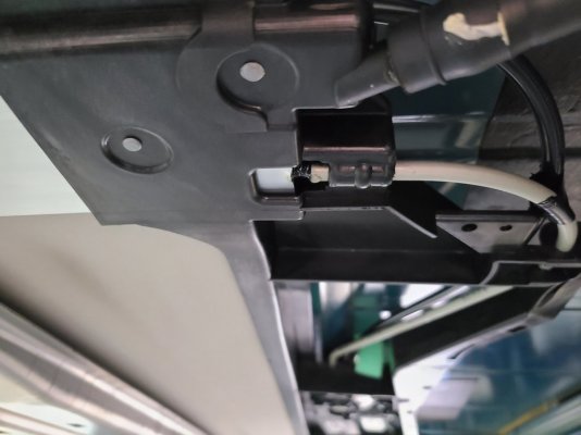

Dropped the headliner so I could see where the issue was. Water is dripping at rear area of sunroof where the motor cable housing attaches to the plastic end cap. Pictures attached. Not sure how this water crosses over from the drain channel to the section that has the drive.
Anyone have ideas

Looking at the pictures, what is the 'white piece' where the white tube attaches to? Is that a retainer clip, or a part of the nipple (where water could leak around)?

So after searching and searching and reading all the info about the various leaks on our trucks, this is the exact problem I was / am having... I had a heavy leak at the drivers side grab handle and at the rear drivers side ceiling speaker... After sealing the hole on the track (as pictured above), the front leak stopped, however it seemed to make the leak in the back worse... After verifying that all (4) drains where clear and functioning and doing the calibration procedure; I pulled the head liner down, I found the exact same second leak coming from the center / back part of the sunroof (as pictured above). I don't see a way to stop the leak and my only thought is my truck has a 3" lift and its just ever so slightly higher in the front and I believe it contributes to the water draining in this direction and its not necessarily designed for that... Regardless it should not leak at all PERIOD when closed, so since this leak still continues today, I order the sunroof glass seal... The dealer is going to tell you that you have to replace the whole glass ($600) and that's a lie, if your out of warranty or don't want to deal with the "stealership'" you can order just the seal ($65) and the glass can more or less be easily removed to work on it. When you reinstall the glass you can then adjust the fitment for a better seal.
MOPAR # 68049128AA
Going to do this work over the weekend and we have a good amount of rain coming next week, fingers crossed this fixes this issue, I will let you guys know.
Wondering if you any of you found any other solutions.

Okay so reporting back here, installation of the glass seal was a success however not as strait forward as I had hoped, most likely special tools (for trimming) required for a factory fit & finish, but I took my time and managed. Also kind of tedious to re-alight and the glass once re-installed, glass is removed entirely for this install, held in by 4 torx screws, relatively easy to remove. We just had about 3 days of heavy rain and finally NO LEAK completely dry, this appeared to resolve the roof leak for me, but was not all the steps I took, just the last... The conclusion we should draw is that not that much water should be getting into the cab to start with and the glass seal is likely the biggest overlooked contributor to most drain or directly related to sunroof leaks. My old seal had signs of rust and when I pulled it off the glass, water came pouring out of it. Here is a quick and comprehensive list of known leaks, what I addressed and issues I have read otherwise:
Pro Tip: The sunroof track is very greasy, easy to muck up your interior, be mindful; use gloves and keep plenty of rags on hand.
Check / Clear (2) sunroof front drains (easy)
Check / Clear (2) sunroof rear drains (difficult)
Sunroof Glass Seal (or replace entire assembly)
Seal holes in aluminum sunroof track
Reseal "shark-fin" satellite antenna
Replace 3rd brake light (seal)
Note: The aluminum track was the main contributor to the grab handle leak as far as I could tell, did all the other steps and the leak from the liner mounted speaker didn't stop until I replaced the sunroof glass seal last... However I feel if the was my first step all the other issues would have been non-existent, I am not convinced my 3rd brake like was leaking but for $20 you can get a Dorman one and I just replaced the whole unit. My shark fin was 100% leaking, just cant tell what part for this story it was contributing too, I sealed it up with clear silicone in my second pass.
