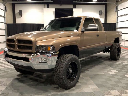

I thought there were two bumpers. The standard one that goes from 94-02, and the sport of the same years but with an additional change in 99... but what about this one? I found one for sale, but can only find a handfull of pics of it.
Edit: It's a 4th gen bumper. Apparently a somewhat popular conversion.

Custom brackets required, the 2500 and up is what you want. The brackets are pretty easy to come across if you do some searching. As you said it has become a popular conversion. My only gripe is that without a lot of custom work it will always be a 50-footer. It fits well enough, but there are usually gaps that are not very appealing.
