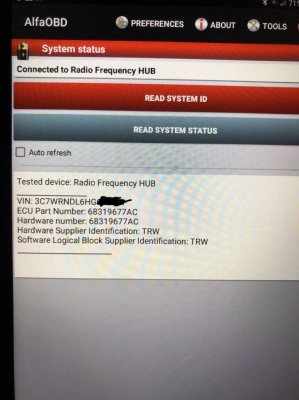

Well that's interesting. Btw it's 02/17. Connected to the rfhub and did a remote start antenna test. Failed. Locate learned keys. Detected none. I can't access the rfhub as yet because my c&c was heavily unfitted modified and the rfhub isn't where I was told it should be. But I'm going to see him tomorrow to find out for sure where it's at. I have remote entry so I know I have one. Ha ha
Go on the alfa again and connect to the radio frequency hub. After connected, select the battery icon on the bottom right. Select read system ID. Where it says ECU part number, that’s the part number of the rf hub in your truck.

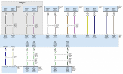

This is what im seeing, note the 4 passive entry antenna (2 with inline connector and 2 without)
The "premium" pre-made kits come with 4 antennas.
Also note the lack of connectors for *rear* door handles....maybe my AllData only shows standard cab config, but Im not sure what the pre-made kits connect to with the rear door handles.
