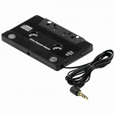

Thought I'd bring an update to this topic as I have found a solution that suits me very well. Up to you to decide if it does for you as well.
Total cost : ~10$, 1 hour of optional work to "hide" everything.
I have purchased a tape cassette adapter for about 3$
and ordered a Bluetooth audio receiver from ebay for about 7$.
I can easily connect my tablet, smart phone or other bluetooth device to the receiver and get what I consider to be very good sound, considering the noise level in the truck is high to start with and would not allow for a high definition sound experience anyhow. Sound quality is actually better than the radio...
The "hidden" part is that I took the time to open the radio up to route the wire coming out of the cassette adapter internally through the radio and out the back of the instrument panel, and connected it to the BT audio receiver. I also added a 12V. charger/adapter to the receiver as it is battery powered and hooked it to the Radio power wire so it would power on/off with the radio.
Everything is tucked away under the panel and does not show. I even left a little bit of play in the wire coming from the cassette adapter so that if I hit the eject button accidentally it has enough to come out and be pushed back in without any issue or breaking the mechanism of the tape player.
Have fun !

I have ordered the Bluetooth Cassette adapter as I found it for 25$ shipped. It works very nicely and it has a Microphone to support phone calls through the radio which is nice. However it does need to be charged, I somehow thought it could be powered by the radio mechanical but it is battery operated.
All in all it works well and I am happy.
