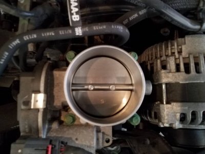

I just installed my catch can at 34k miles (bought the truck used). I attached a picture of the throttle body. Pretty damn clean.

Excellent and the catch can will help it stay that way!
Sent from my SM-G935T using Tapatalk
LOL , Of course that side is gonna be clean , if it's not then you have other issues
The other side of your intake flapper is where the crap starts but most of the nasty stuff and carbon build up is much deeper , you can see some of it with a bright light and small dental mirror .
The best way to really know how much buildup you have is to remove the intake manifold ( I do not recommend this )
Either way installing the OCC at 34k isn't bad at all !
I installed mine at 22k at that time I had litle vissual build up inside the plenum ( that I could see)

Lol. Right.
I did look inside, as much as I could with my phone light and no mirror. Finger swab yielded little residue.

Good deal your in good shape Sir just as I was , I do wish I'd installed my occ sooner

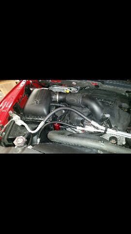

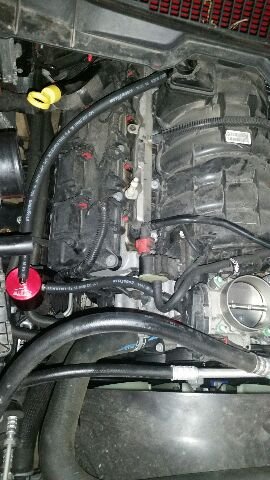

Had two catch cans on my Focus ST. PVC side and crankcase side. Where are you guys installing on the Ram?
Here's mine , I mounted it in an unused threaded hole in the area I needed one
I didn't have any install instructions with my occ , pretty sure if you buy new they would have instructions.
I purchased a new one for my wife's car and it came with great instructions.
