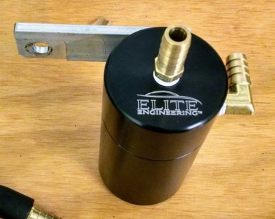

I purchased a new PCV valve (Mopar part # 53032925AC) from Ebay and the oil catch can from Elite Engineering. The kit that I chose is the 2006+ Hemi 5.7 because it comes with ½” rubber hose and a hose barb coupler to make the connections to the PCV valve and plastic line on the 4.7 motor. The kit also comes with a short bracket to mount the catch can in the engine bay.

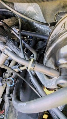

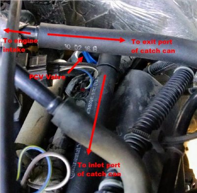

1. Disconnect the black rubber elbow fitting from the PCV valve which is at the rear of the driver’s side valve cover. Pull the elbow fitting from the plastic line/tube that goes to the intake. You may have to twist the fitting to break it loose before pulling it off.
2. Remove the old valve and install the new. This requires a 34mm socket.
3. Install the hose barb coupler to the smaller hole on the rubber elbow fitting that was removed from the PCV valve. This coupler will accept the rubber hose to the catch can.
4. Reinstall the elbow fitting onto the PCV valve, pointing toward the front of the truck. This step helped me better determine how to route the rubber hose and where to cut it.
5. The rubber hose with the kit comes as one long piece, DO NOT cut it until the catch can location is determined.
6. Assemble the hose barbs to the catch can with thread tape and mount the bracket. Originally I used the brass hose barbs that were included with the kit, however I chose not to use the straight fitting in either location. It would cause the hose to kink over time. So I purchased black nylon, glass reinforced, elbow fittings (Eldon James L4-8GFBN) from Amazon that were actually a tighter fit with the rubber hose than the brass fittings. The catch can ports are ¼-18 NPT.

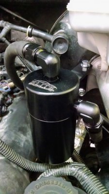

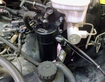

7. Install the catch can - I installed the bracket on the brake booster and sanded the corner down to fit in the recess on the brake master cylinder. I used an M8 flange nut and medium threadlocker to secure the bracket.
8. Install the rubber hose on the PCV fitting, route it to the catch can, trim to length and install it on the hose barb on top of the catch can. Before cutting the hose to length, I marked it with tape and then routed the other end from the exit port back to the PCV tube just to be sure - measure twice, cut once! A little WD-40 on the barbs and PCV tube makes it easier to install the rubber hose.
9. Install the 2nd hose from the exit side of the catch can back to the PCV tube that runs to the intake. I ran this hose behind the brake booster to keep it away from the exhaust header.

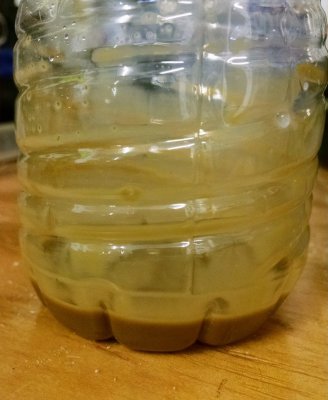

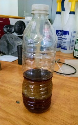

This is what I poured out of the catch can after about 500 miles. It's not much, but more than I was expecting. I'm glad this stuff isn't going into my engine!

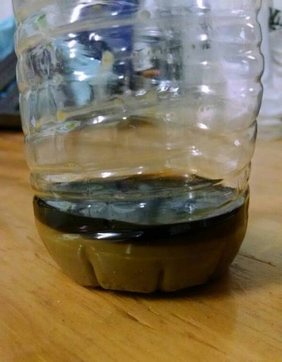

I poured out the can after the oil change on Sat, this is the total after 700 miles. The dark layer was the first 500 miles, the bottom was an additional 200. I predicted that the regular short trips would add up quickly. 7a12b158eeeac4475c46dab5fa23da5f.jpg

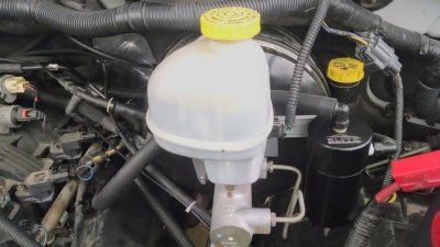

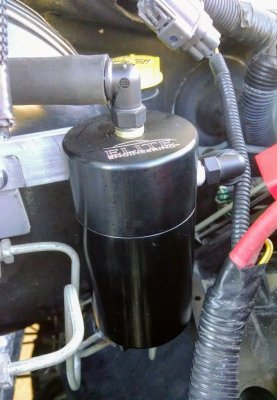

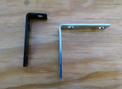

Today I relocated the catch can to the other side of the master cylinder, away from the battery box. I needed more access to unscrew the cup. I modified a simple angle bracket to bolt to the master cylinder mounting nut.
I purchased a new catch can bracket from Elite Engineering, their LFX mounting bracket.
I also purchased AN fittings (bottom) from Summit Racing to replace the plastic fittings I originally used (top). The elbow is a 8AN to 1/4" NPT and the other is a 1/2" push-on hose barb to 8AN. I used some WD-40 to slide the hoses on the barbs easier. I can unscrew the hose barbs from the elbow anytime I need to remove the can from the truck. The plastic fittings were much harder to remove.
Here's the final install. I had to shorten the inlet hose from the PCV valve to the top of the can, but the return hose was the correct length to the new location.

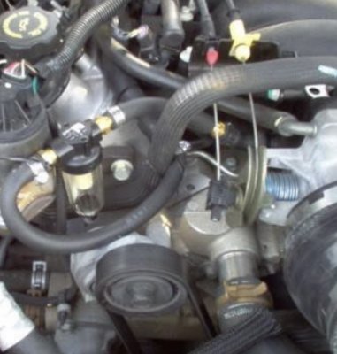

I've done the "Home Depot" catch can on a couple of LS vehicles, thinking about adding one onto my Ram. Just grab an oil separator for an air compressor at the tool/hardware store and a couple of barbed hose ends, and splice it inline. Usually $10-15 total. I used a smaller one than this, but it gives you an idea.
