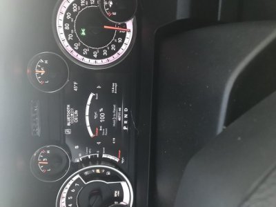

So I changed he oil in my truck reset the oil life percentage back to 100% but the dash still has the word “change” lit up in red. If I remember correctly good was lit up green when oil was changed . Anyone know how to fix that?

Turn the key to "on" without starting the engine and press the gas pedal down 5 times, then turn the key back off. That's how it works on my truck but I dont have the oil life gauge so it may not be the same

The CHANGE light is not green when reset, it’s always red.

He's correct turn to run and I have to press mine 3 times and it resets. A day I do have a oil life gage.
