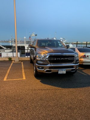

Hi,
Cool color on the truck. What the heck is that? It’s not the rugged brown, is it? I just ordered one, and rugged brown is unavailable now. I don’t recall seeing that color on the Ram build site.
