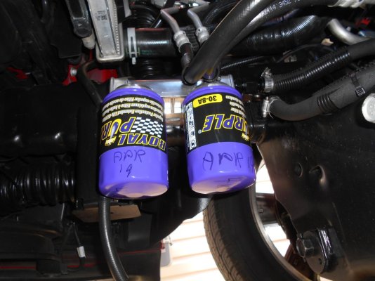

I'm no fan of Pac Brakes kit,but at this point in time they're the only ones with a truck specific kit.
I run Transdapts dual filter set-up,but it needs a bit of work to fit a truck.
