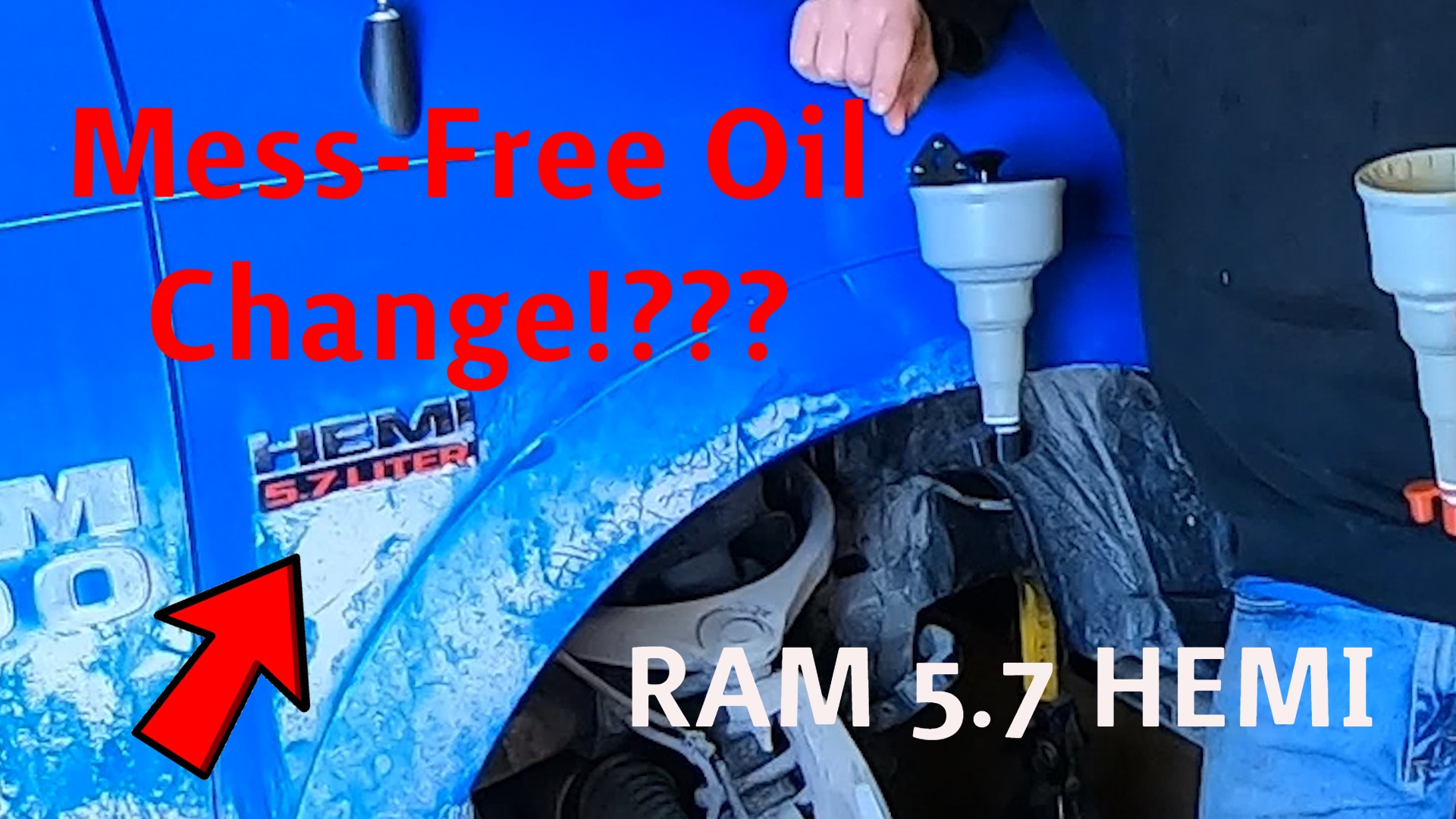

Unless someone he man'd it on, an oil wrench/oil strap should loosen enough for you to turn off. Just got the Oil spray which is why I have an Oil Udder for this. There are also threads where people use 1 gallon or such plastic jugs for a way to direct oil drain from splashing all over steering setup. But you gonna have to reach up there and put whateva you use on the filter. I also have an oil filter metal cap that fits over the end of the filter with a 3/8th adapter to put an extension off of a 3/8th socket on to turn off the filter. I have one that fits my motorcycle and tractor. You would have to source if you went that route to get correct size to fit over end of filter.
This would work where it is adjustable depending upon filter size: Disregard the down for MX, just click on link. U may have an Advanced store in your town, I do not.
There are just so many options from Auto Stores: Above just one option: Google Oil Filter Removal Tool.

Turkeybird, how does that "oil udder" work out for you ?
Squirrel1270
Air Force Retired
Supporting Member Air Force
Apr 8, 2019
59
41
NJ
I tried the oil utter and couldn’t get it to seat. Not enough room. Went back to the gallon sandwich bag.
