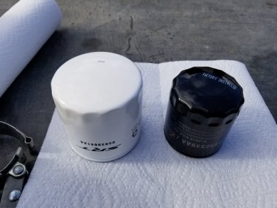

I use an SRT filter on my 2019 Classic. Fit is tight, but I don't have the start up clatter with this filter and Redline 5w20 that I had with the factory filter and oil, which I changed at 2,000 miles. Here's the SRT vs. factory filter for comparison:

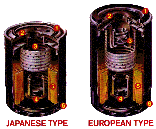

Here is a picture of the breakdown on some oil filters anatomy
As you can see, some bypass valves are built directly in the middle of the filter while a few do not have one.
Here is a cutaway of Bosch's and how each component is located in a filter.
1) Rubber seal
2) Steel baseplate
3) Anti-drainback valve
4) The bypass valve
5) Filter media
6) Filter can
Hopefully this gives you a better idea about filters and how they flow.
