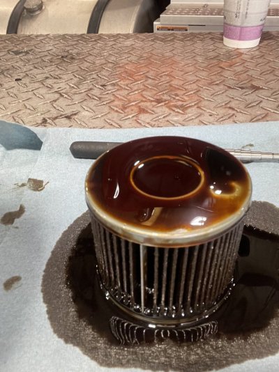

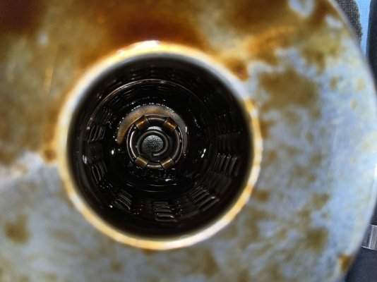

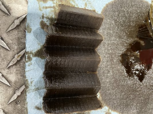

Tore apart my SRT filter. This is after 12K+ Miles, and a little over a year. Not sure whether this is paper or the MicroGlass. All I can say it is extremely stiff. Do what you want with this info :)

if there is wire mesh behind media, it is microglass. If there is no wire mesh, it is paper. They use binders for paper filters, those binders stiffen with heat cycles in oil. This is great info, thanks, so much we don't know about srt filters, seams like half of them are microglass, and 1/2 of them are paper, dunno? Reason number 537, just use royal purple filters.

Correct, no mesh behind the media. Installed the 20-820 now.

No wire backing = cost reduction, while still weasel marketing the word "synthetic" onto the label.
Same as semi synthetic oil. Consumer market is awful. Glad I worked in commercial products my entire career. There's enough charlatans there.
