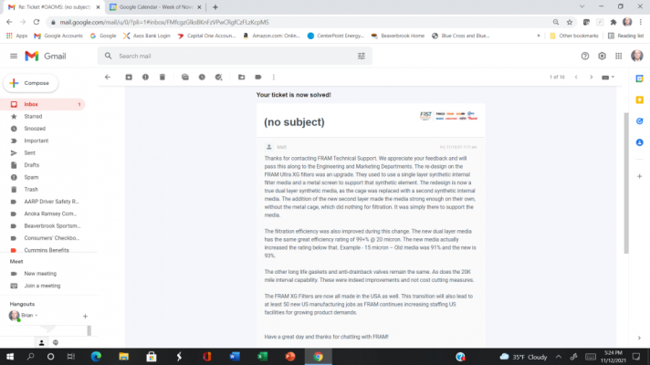

I'm unclear what the marketing-speak means.
"Synthetic Blend" media in the past had meant a blend of synthetic and cellulose media, or layers of them.
This Fram guy (Matt) is saying the new XG Ultra media is 2 different synthetic layers instead of formerly one layer of synthetic media, and it doesn't need a screen.
Then he says it filters better than the original below 20 micron particle size.
Do you guys see anything different in his statements?

Members -
I sent an email to Fram inquiring about their re-designed XG Ultra Oil Filter. Below is the response. Thoughts?
Great score, do you believe it? I would try it in the wife's car, which is a canister so easy to test, no need to cut open a filter. I will commit to testing it next year, i just changed her oil so wont be needed til next year, probably will have verification next summer. I tell you, I'm not impressed with how they go about changes and informing people, and I need to go back and look at what they actually say on ultra now.

Not these days. Sorry, but the level of corruption and dishonesty these days requires validation of most things.
I will be keeping an eye on this. I may write back requesting validation. Recall Fram was bought by Trico conglomerate. Set up to fail just as the originator GE is acknowledging Jack Welch failure and divesting itself. Sucks.

This is what they say below, now we all know what synthetic blend means. So I really do not like they did this, everyone else who says synthetic blend means with cellulose. I'm going to believe what they say even though I don't like it and verify, because I have appreciated fram for having a synthetic media filter. Now, here is the real question, even if it is what they say, would that make it better then the top choices we have? Screen or no screen, which is good? Do they add binders to make that fiber hold? Just treat the second layer as they do with cellulose and add binders? We need some ram members to step up, I will do it but it will be a while before we know.
Designed for use with synthetic oils.
Dual layered synthetic blend media provides 99%+ filtration efficiency.*
Durable metal tube offers outstanding pressure resistance and flow spacing.
It is just a new thing, we never heard of synthetic w/o mesh. Hopefully it is an upgrade, let;s sleuth this puppy.
