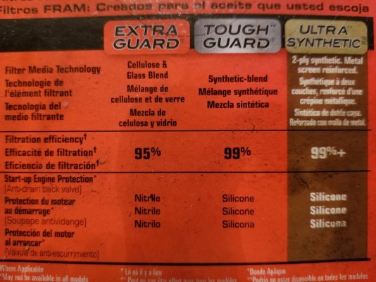

Update for y'all - I had a Fram Ultra Synthetic XG5 Oil Filter in stock I bought early in 2020 that I used this weekend (for motorhome engine, not Ram Truck). It had marketing spiel on the carton definitely indicating these filters were dual media all-synthetic before Trico bought them out and cheapened them, changing to synthetic blend media without metal screen backing. Notably, that's what their former Tough Guard Filters were.
Here's a pic.......
Ultra Synthetic was "2-ply synthetic. Metal screen reincfored. 99% efficient @ down to 20 micron, silicone anti-drain back valve."

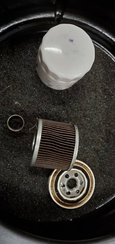

Well, I think we can safely conclude the SRT filters are paper media. Might be a "premium" paper media, but still paper. Cut mine open the other day that had 5400 miles on it with 2 camping trips into the NH mountains where the oil saw 245⁰ for extended periods. Not the worst I've seen which is why I think its a premium paper media but the pleats are definitely waving.20211013_195717.jpg

That's disappointing. Thanks for updating, real bummer because some where definitely syn, and some are for sure paper.

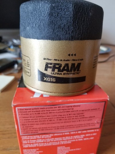

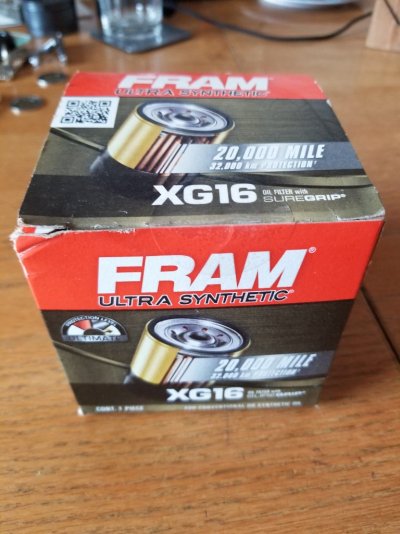

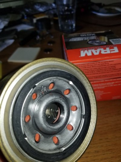

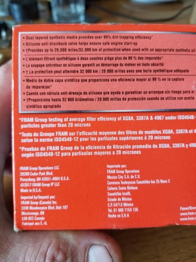

Hey guys
I was rummaging around in my tool box this morning and found an old xg16 from my old ram
if any of my fellow canucks would like this true syn media filter I will send it to them for the cost of shipping plus a beer! PM me
