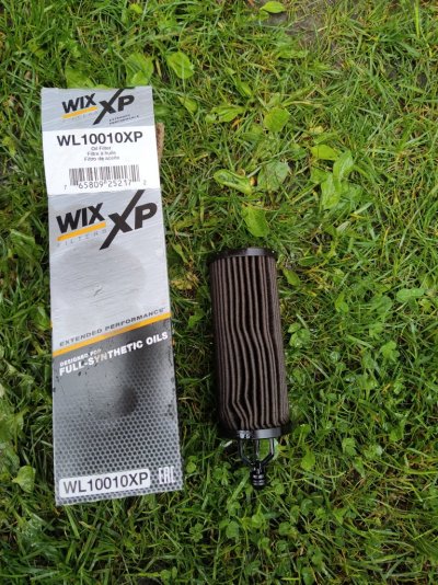

Squish looks the same as the stock filter from the last oil change. 57 days, 34% remaining, 8250kms on this Wix XP filter, 2300kms were hwy towing. M1 truck and SUV 5w30.IMG_20220620_132847.jpg

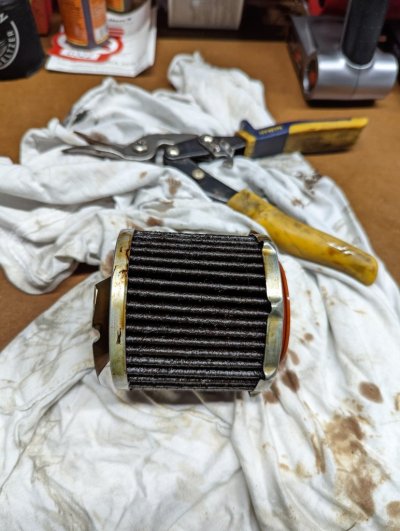

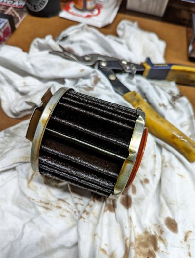

cut my Fram xg2 non wire mesh style open, 5,167 miles

thanks for posting.
was it all crunchy? good no signs of vacuum.

It is hard, or shouid i say ridgid but moves, maybe that's how its able to hold its shape with the 3 layers they say its made of?
I can pull it a part more if you guys want...

yes we want inside pics!

Just get a can cutter from Amazon if you're into it.
I'd do it if I had access to a flow bench.

That xg2 is thicker also, took some muscle to cut through the edge.

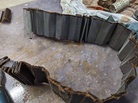

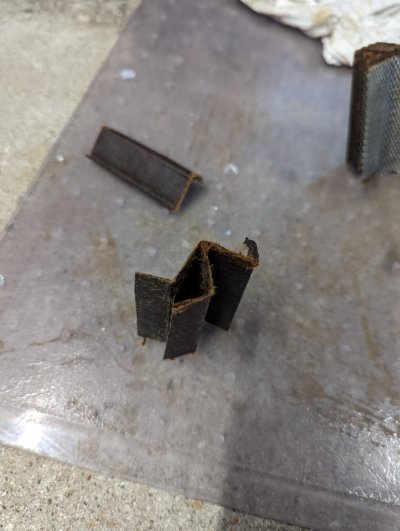

Ok so the xg2 is tuff to cut and pull apart!
Still pliable and didnt crack or anything. Backing is wire mesh and was able to separate 2 layers without it ripping into little pieces.
If i remember correctly someone emailed them and they said it was 3 layers and indeed synthetic still. Looks quality to me!

good work thanks!
If you magnify you see the top of that media all stringy, looks like fiber not paper.

Yes definitely, i never pulled a paper one apart but have used those cartridge styles on a Toyota and this is definitely not that paper stuff.
