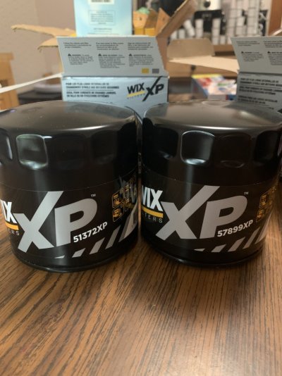

Made a discovery... wix xp 51372 is identicle on size as the 57899xp however, higher bypass setting and higher flow rating. I did some digging and found this filter has a 22 psi bypass setting and flows 11-13 gpm while the 57899xp has a 16 psi bypass and flows 9-11 gpm...
Wix are rock catchers. Poor efficiency. Recall Burla's test comparison.

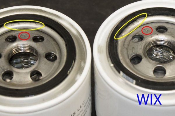

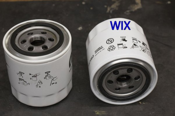

Who makes the srt filter filter anyone know?
answers your question travis in a round about way.
Answers my question too )
The SRT engineers worked with many of the filter suppliers to get the best features. Some fell out for various performance reasons but they ended up developing the current SRT filters with Wix, a mainstream manufacturer.

Sorry for all the people I pi ss ed off with that one, but please dont shoot the messenger.
I was saying, hmm that pic travis posted looked like some of those srt filters, lol. yup. Must not be xp though, I still think we have some examples of srt = blended filters.
