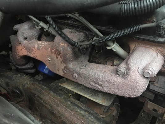

I can't take it to auto zone because it wouldn't start, however, when I went outside to check the rpms I got the car to start. After it started I popped the hood to look under because it sounded a little funny. I saw smoke coming out of the rusted looking part on the side of the engine not sure what that is called. The weather was rainy and 46 degrees in case that makes a difference. Photo attached 8b3da0f665bd97e687419097e762be98.jpg

I did some googling and it is leaking out the exhaust manifold.

That is one crusty engine. An exhaust leak won't stop it from starting and running, it just might not run as well. You'll really want to get it somewhere to check the codes. If you're afraid of it not starting back up again, just don't shut it off. It doesn't matter what the autozone guys say, nothing bad will happen if you plug the scanner in while its running, the OBDII port always has power anyway. You will want to make sure the cigarette lighter works, usually that fuse also provides power to the OBDII port.

Looks like you need to do your valve cover gaskets too. May be leaking oil from there onto exhaust.

Leaky valve covers can be dealt with in time. My personal first order of business would be that coil wire being so close to the manifold. Looks like it's been doing some melty type **** sms being as that carries all of your spark energy, it's not currently doing you any favors
