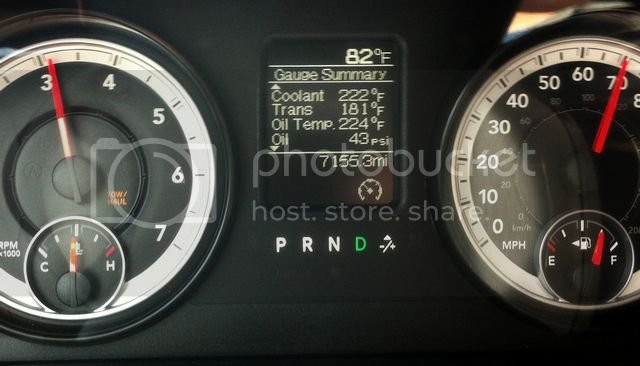

I realize that you are talking about the 5.7 engine, however, on a recent 2415 round trip to Florida with my Pentastar, 8 speed, and 3.21 rear end I was pulling my Winnebago TT (21.5' 4500# loaded) most of the time between 65 and 70 mph. Here is a typical photo of the EVIC while towing in tow/haul mode. I used an iphone4 to make the photo. This would be a good way to document your high temperature for Chrysler and the dealer.
